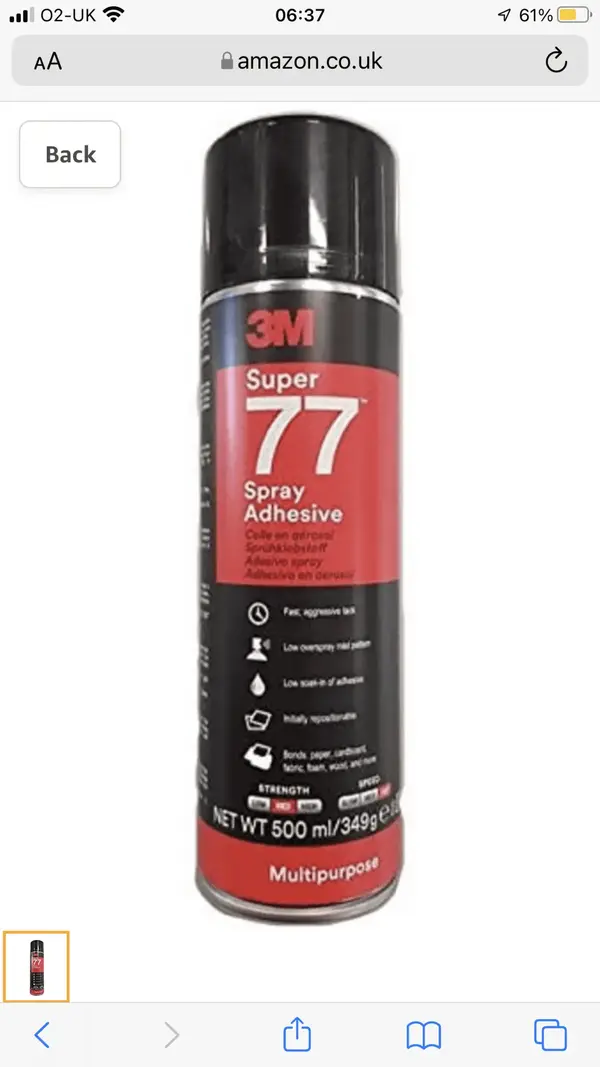

I’ve used a 3M spray adhesive product on clear, it works really well and lasts. You need to mask up the area to cut down on clean up & you can use a citrus adhesive cleaner to remove excess whilst not damaging the graphics.

Good thing about modern high strength spray adhesives is you can have multiple attempts and clean up.
Super glue can be awesome, but if you get it wrong you’re stuffed, oh until the winter when you bring your freezing aluminium wheels indoors and then it just cracks off! 😁
