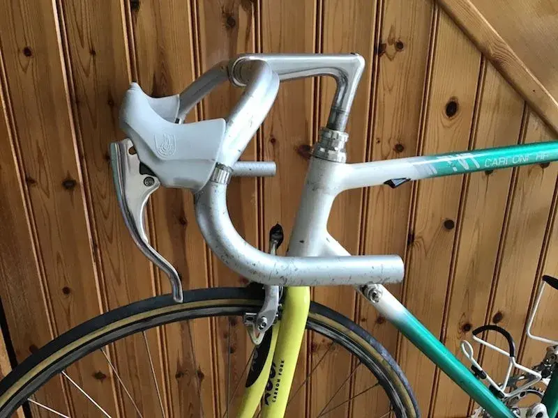

I am not sure what water bottles were used, sometimes TA bottles are seen on the bikes, these are American Classic

Cinelli Criterium handlebars - I might swap these out for 44cm bars (they are 42cm)
44cm bars single grove would be closer to Sean Kelly's bike spec

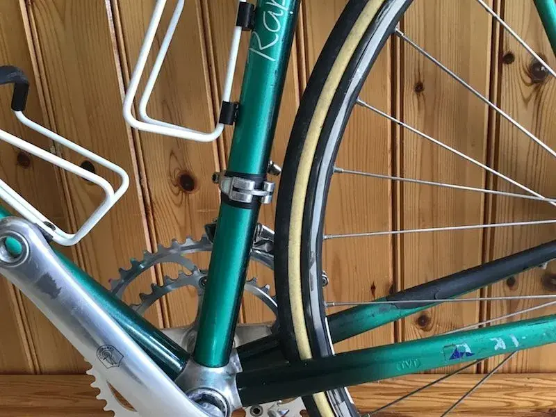

campagnolo adjustable band on deraileur for TVT frames as they are slightly wider diameter than the standard steel tubes.

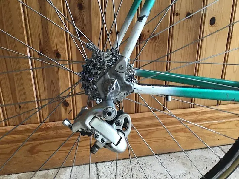

1993 campagnolo rear deraileur normally used with ergos but should be fine with these 8 speed downtube shifters, As I said, the drivetrain is 8 speed with the curved downtube shifters - they are the easiest to set up for me!

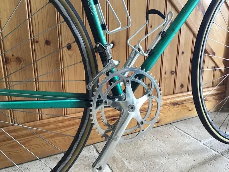

The chainring is also record from 1993
I think the front deraileur is chorus

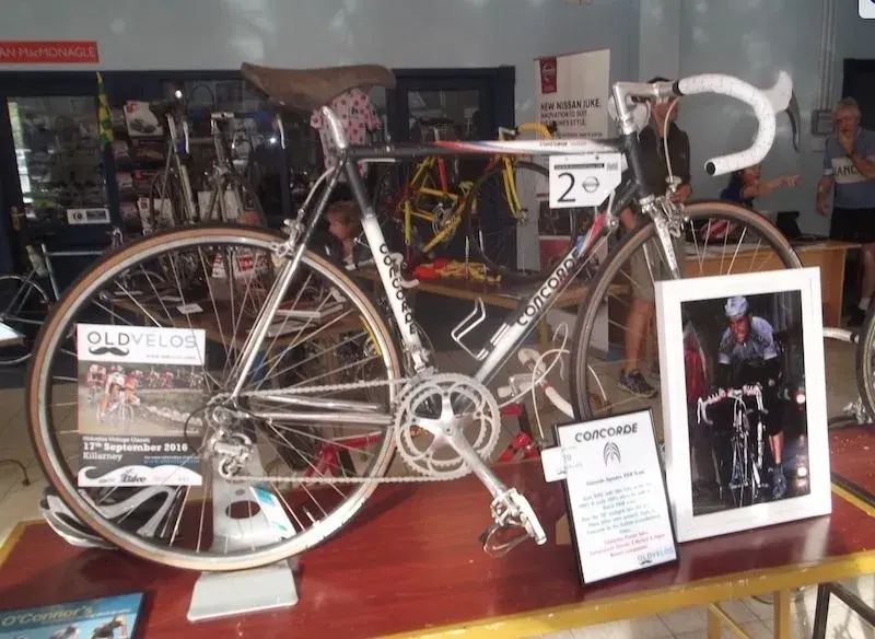

I took some photos of one of Sean Kelly's bikes from the the 1990/91 season at the Old Velos cycle a couple of years ago in Kilarney in Ireland. The pedals are interesting, I have C record road pedals on order from ebay, however these look like c record track pedals on Sean'S bike - also the cable routing is external on the Concorde Squadra team bikes

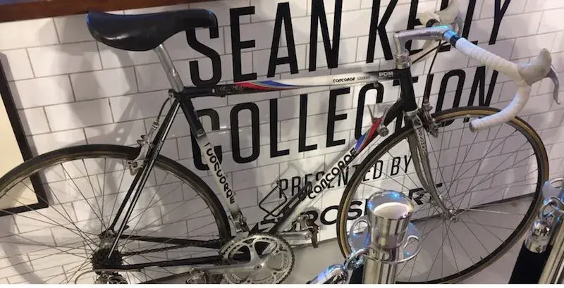

Sean Kelly recently put on display one of his own Squadras. It too has track pedals.
