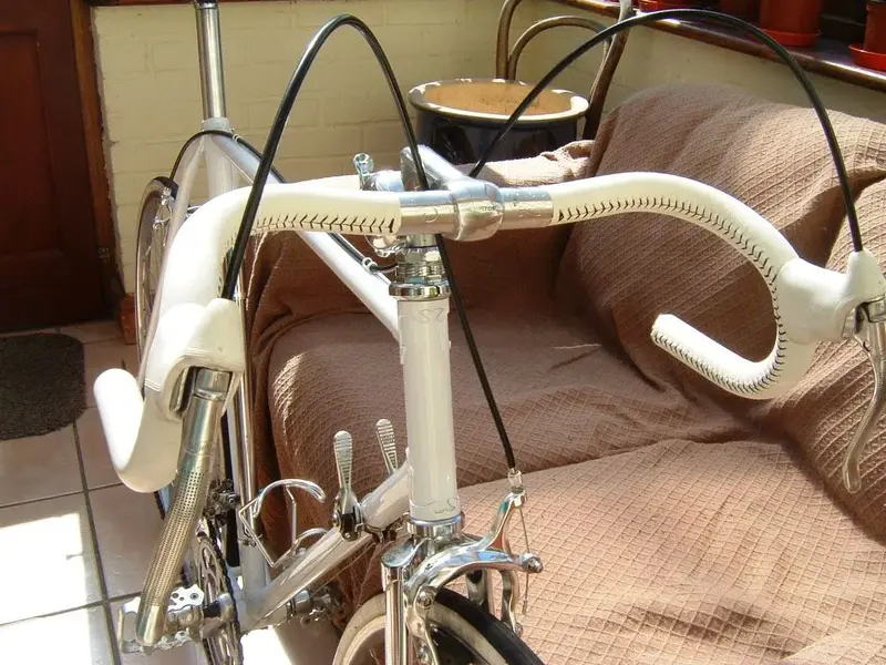

Yes, most bikes of that age will need some t-cut, ferecla, elbow grease... Or a complete paint removal and repaint. Personally I'd go witn the t-cut route, it doesn't look that bad.
How have you tried to remove the BB?
I remove the cranks, knock the lock ring off with a hammer, soak with plus gas/wd40 for a while, then stick the cups in a vice and turn the frame, always works :-)
Fixable.... Absolutely :-)
As for the bars, you could rough sand them and cover them in leather "almarc" style like I did with my galaxy :-) a really good post on here on how to do it. Looks excellent with polished levers and new hoods.
Yeah, go for it, especially now you've got new wheels coming :-)
Cheers
Rich :D :mrgreen:
Rich :D :mrgreen:

yours look very professional - i used a thick 'cork' tape - not fancy - but it provides cushioning for the Dupuytren's Contracture in my left hand
