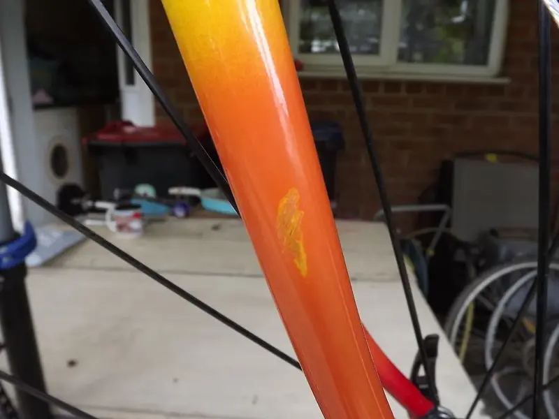

On to the question of blemishes after building becasue well, Mr impatient just couldn't wait and built it up, and then onto dealing with said blemish and the risk of overspray.

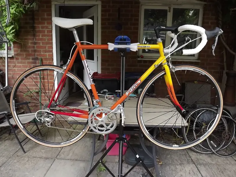

Built up bike below apart from waiting for some new brake blocks (it comes in a very respectable 10.4Kg built up) and can you spot the cause of a lot of high language yesterday when I found it?
Well spotted at the back yes some sort of mark on the forks. It looked like I touched it with my shirt or something after applying the last clear coat and just didn't see it and the picture above is after I'd found it and tried to polish it out, it didn't work obviously but it did get it ready for sorting out.

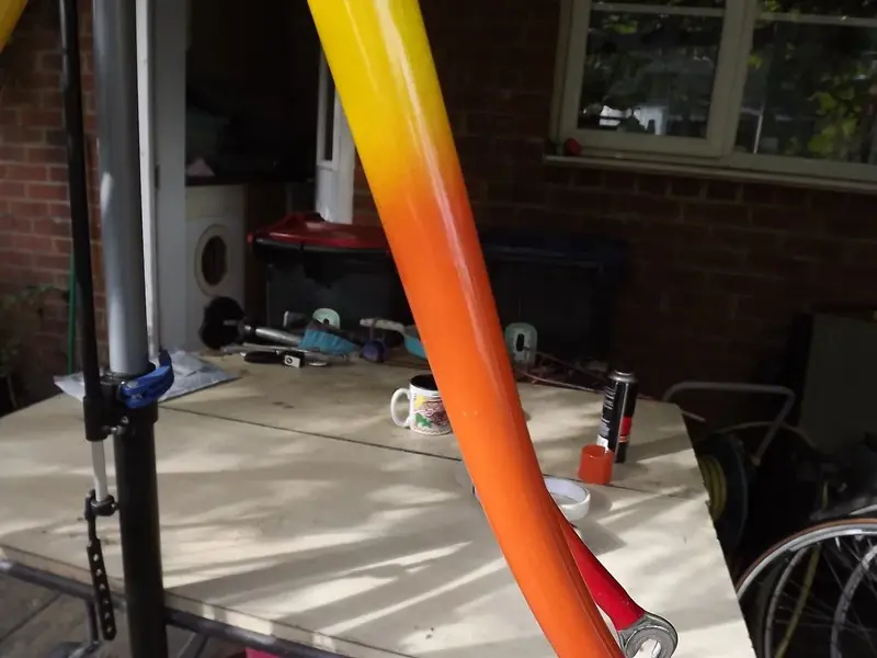

Ok how to deal with a small localised blemish like this well, flat it as locally as possible. (1st picture)

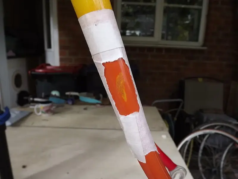

Mask lightly and loosely around the blemish and make sure you leave the edges of the tape flared up ragged and most definitely not pushed down hard, you want a very feathered edge so that you don't leave a hard edge with your paint. (2nd picture)

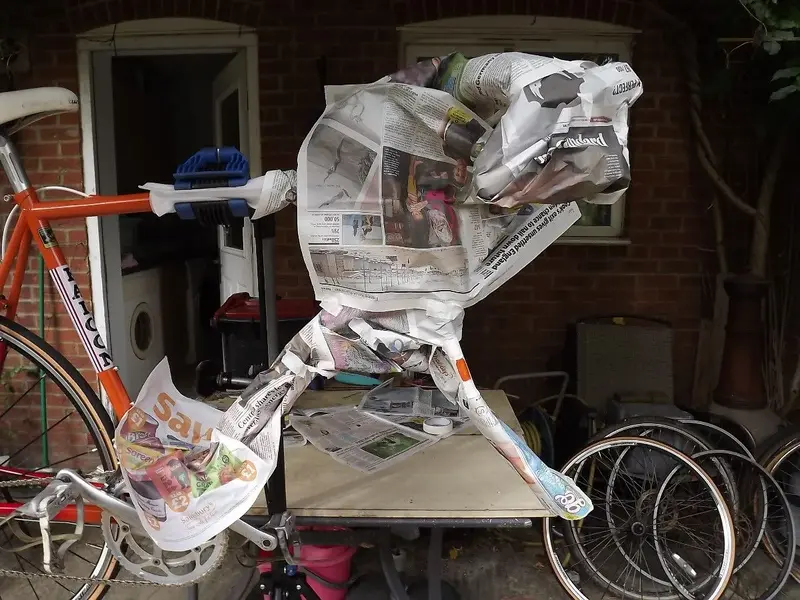

Right now cover as much as possible with masking paper (I know I'm using newspaper and I said not to but needs must and it will be on for no more than a few minutes) (3rd picture)

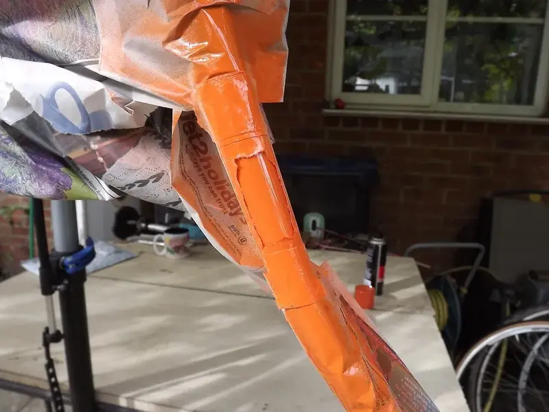

Apply your paint as locally as possible without actually just pointing the can at the desired area and pushing the nozzle down, you still need to move the can about to get a good application and finish. (4th picture)
Lastly, straight away remove all the masking (5th picture) this I will allow to dry and then polish out the minor high edges and then re clear coat the forks completely and for that I will remove them to do it.
