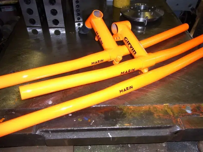

Some orange handlebars, not sure painted bars is a good idea.
Putting the bars in those stems was a delicate operation.
Yeah, I'd been thinking about this... I assume you put plenty of wax on them and wedge open the clamp open.
