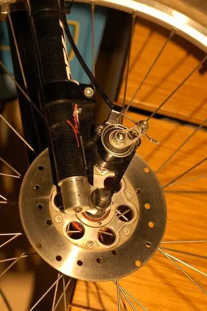

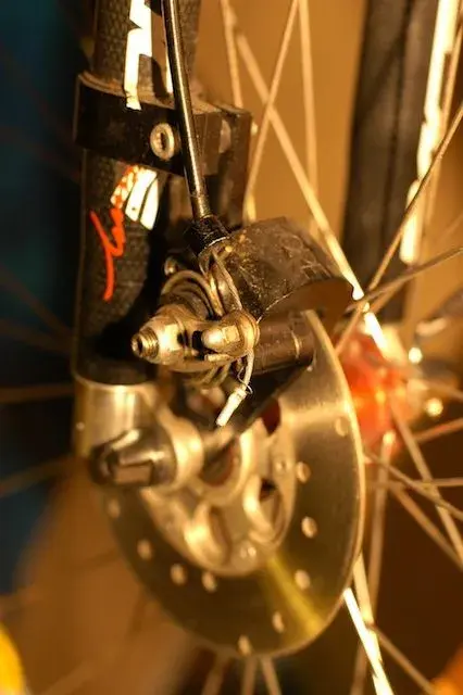

Just for reference.. this is my disk! Anyone ever seen one before?
I got a reply from Hope who said I could probably use my hub together with a new spider for a newer hydraulic setup... I'll have to get it back and running and see how I get on!
