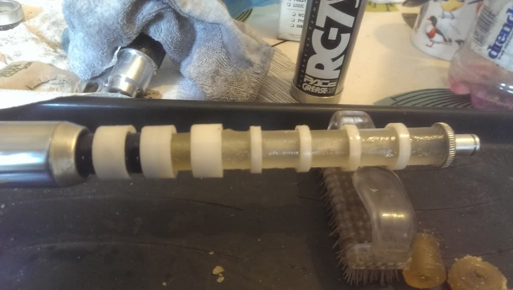

This is the set up I went with, but I was only replicating the original set up. IIRC the instructions suggested that you could play around with positions and combinations to suit the individual.

I downloaded the manual as a pdf from www.suspensionforks.net/pace and notice that for 1996 standard elastomers fitted to the MCXD were 2 blue (hard) , 5 natural (medium) and 1 yellow (soft). It also says that they should be fitted hardest at the top.
