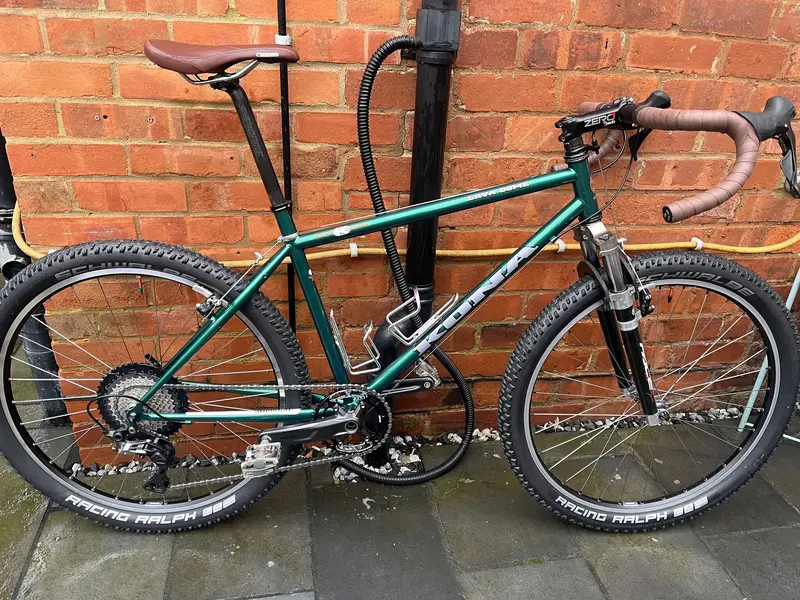

Hi Tim @justbackdated trying to obtain a carbon bridge for RC36 forks if it is even available! Changed from Ally to carbon and it’s either getting a nice hanger to match or changing to v brakes with the tanpan type adapter which doesn’t look great if I am honest. Kona lava dome retro gravel conversion! ☺️☺️. Any help you can give. 👍
Attachments​
Attachments​
Sorry should have said. Need the brace to have the stop / hanger for cantilever brakes. I know they did an alloy one.
I don't think they ever did a carbon canti bridge, and the aluminium ones are pretty rare. That said you could possibly make a new front one out of sheet carbon to replicate the aluminium design and bolt a guide to it with some ingenuity.

Fork on Kona is a 1997 RC36 with aftermarket carbon bridges. Best not to drill for canti rocker, although I have seen it done. ‘97 was the last year that an alloy canti mount type bridge was offered by Pace, as stated; a bit rare now. Hope discs and V-brakes were the new thing, so few canti mount bridges were made in 1997. Unfortunately there is no real alternative to mount canti brakes at present.
Mmm, I love a Kona!
