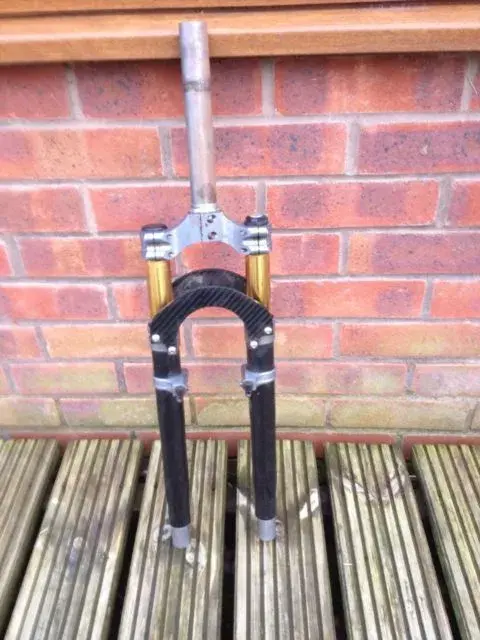

(Think these are 1997 rc36 evo pro class)
