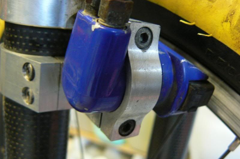

what would i need, officially to make a good job of fitting them to the rc35 fork?
as in perfect fitment.
I need to brace my HS11s (using RC35s) but the Pace mounts that are on mine are just the clamp type - no legs.
The problem is that the action of forks is compramised as I have to do the leg clamps up really tight to stop Maguras from moving outwards under braking. Loctite has been suggested - but to brace across would be ideal. Any thoughts?
