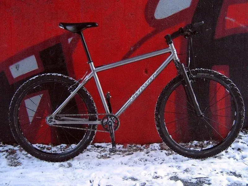

Paint chips to the magnesium wheel drop-outs is common, but as long as they are in reasonable shape there is
nothing to worry about really. All versions have the disktab, but you can add v-brake clamps too.
I've got them on two bikes at the moment, love them and trust them....not that I do anything too rough or crazy though.
Awesome bike!
