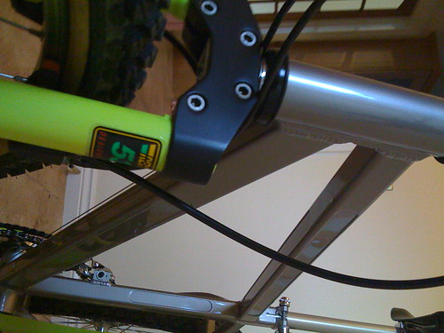

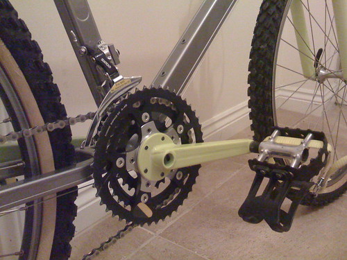

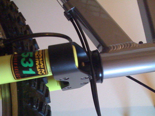

Crikey its been a while since last progress report....
Well then, where were we?
Paint. Wasn't happy with it. I think the colour was a little out and there were a few small marks in the paint that I couldn't live with. So I pulled it apart and stripped it, re-mixed the paint and started again. I spent a little more time prepping this time and got it perfect before laying on the paint. Result- spot on! Colour looks much better (slightly darker), finish is flawless and it has a much better shine this time.
So I'm back where I was last time I posted but happier with the result.
I managed to find some Grab On grips for it, some NOS Mt Zefal toeclips, matching flouro straps (Tioga) and a seat binder so as soon as I find the cable guides and a set of decals its finished. Been a bit of a saga this one but soooo pleased with the result.
I'm sorry for the crap pics- camera phone, indoors etc. but as soon as the weather perks up she'll be outside for some better shots.
SPEC
Frame: Pace RC100 no. 100261
Fork: Pace RC30
Headset: Suntour XC Pro- modified with floating lower race and machined out lock ring and cap (NOS)
Stem: Pace
Handlebar: Renthal Pace RCsub130 (NOS)
Grips: Grab On MTN (NOS)
Brakes: Magura HS11 Hydrostop
Brake Pads: Magura Red
Brake Levers: Magura
Shifters: Suntour XC Pro (NOS)
Front Derailleur: Suntour XC Pro (NOS)
Rear Derailleur: Suntour XC Pro (NOS) Venhill Titanium bolt, Alloy jockeys
Derailleur Cables: Shimano XTR
Cassette: Shimano HG 7 spd (NOS)
Chain: Shimano HG
Cranks: Bullseye with modified axle to take std size bearings
Crank Bolts: None
Chainrings: Shimano Biopace 26/36/48
Chainring bolts: Generic Alloy
Bottom Bracket: Bullseye
Pedals: Shimano XT M732, Mt Zefal clips (NOS), Tioga straps (NOS)
Hub Skewers: Suntour XC Pro
Rims: Mavic M231 CD (New Mavic MA40's to be built for garage queen use)
Hubs: Suntour XC Pro
Nipples: Unknown
Spokes: DT Swiss
Tyres: Tioga Farmer Johns Cousin 26x1.95 (NOS)
Tubes: Specialized
Saddle: Selle Italia Turbo (NOS)
Seatpost: Suntour XC Pro (NOS)
Seatpost Binder: Kalloy
Extra's: Full Venhill bolt kit, Madison Bottle cages.
Weight: Approx 23.5lbs??
