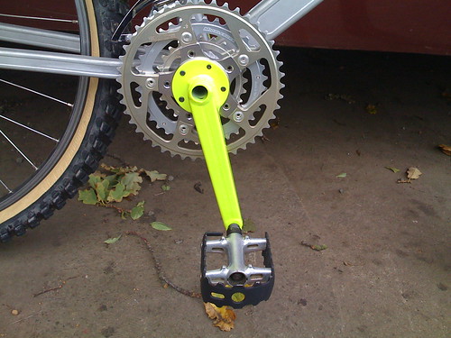

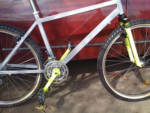

A little progress update. I have spent most of the last few days taking pictures, listing, packaging and posting off all my goodies- quite depressing so needed a bit of a lift and had an hour on the Pace.
Got the cranks in- just awaiting Gil's return to get some decals then its on with the helicopter tape.
Axle machined down to fit the 22mm bearings, new bearings pressed on to the re-finished cranks. I had the paint on the forks matched and painted them, first with an acid etch primer then a coat of white hi-build. Next went the flouro yellow and then finished with a clear powdercoat for toughness.
Now fitted into frame using homemade puller. I've put a silver Middleburn middle ring on for now until a 35T Pace turns up.
I need to find some cable hose clips now so I can trail fit the brakes, then its a blast around the Farm before stripping it all back down for Paint.

It sure will be. I'm going to have some new wheels built for the NOS tyres for when it's in garage queen mode and put some used amberwall conti's on the rims currently fitted for when I use it. I don't like using new parts as there is only so many left and we'll be buggered when they have all gone!
I'm hoping to find time next week to paint the frame- can't wait
