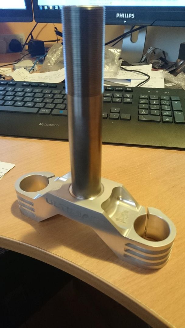

Do you have a picture with them in a MAG or JUDY pressed in crown.
From what I can see there is no external butting/tapering going on? So cannot see how it goes in a Rockshox and be wide enough for the crown and have the crown race section.

Just fitted a titanium steerer to an Ultimate crown.....
Just fitted today to my Fatchance spot on looks so much better now..steer was 100% cut down to the correct length, what a guess :lol: bag on 8)
The one pictured is a titanium steerer supplied to me by racer_x and I made an adapter to fit a 1" steerer to an 1 1/8" crown....
The ones I make for Manitou 3 qnd 4, which I have recently fitted to a Rockshox crown for SEANSTEPHENS are 30mm at the bottom end which presses into the crown and comes through about 8mm for the crown race to fit and then reduce down to 1 1/8" for the top race and stem to clamp to.
Hope this helps.
Cheers
Rob
