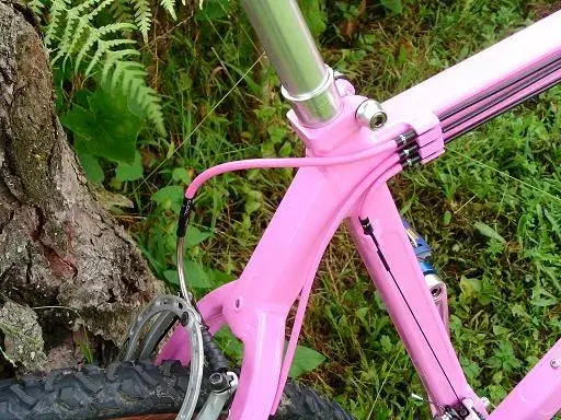

Hi Guys,
Would anyone know if the brake rockers used on the RC35's BITD were the same as those used on the original RC200 framesets on the rear stays?

Nope, check it out, I have a thread on the bottom on my mono stay, sure that the original RC200 F1's had rockers...

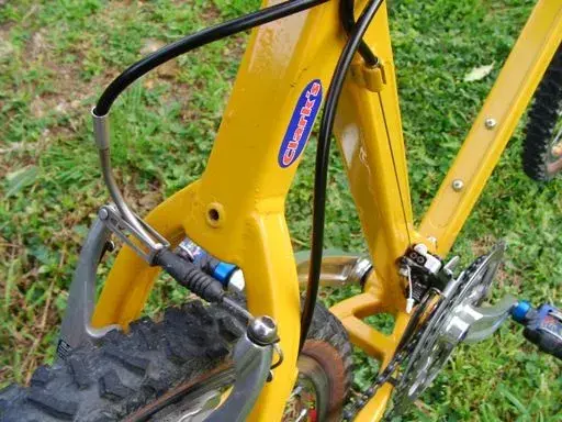

Hi Rich, Pace did fit a rocker for the rear brake to the original new for '92 RC200 frameset. You should be able to work out if it was the same as the RC35 fork as that fitted to a spigot on the bridge using a circlip. Do you have anything welded to the frame for it to fit to or is it just a screw hole on the rear mono stay, that would suggest a std type rocker anyway hope this gets you thinking Cheers Max. Ha Ha to slow in my reply you have posted pictures
Cheers Max,
Didn't think I was going mad :wink: , so a standard rocker might do it do you think?
