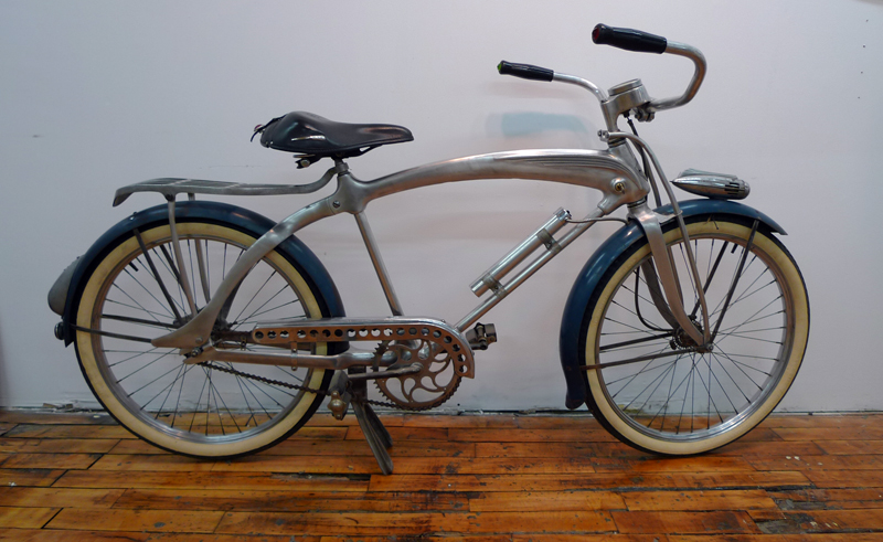

Monark Silver King from 1948
1938!

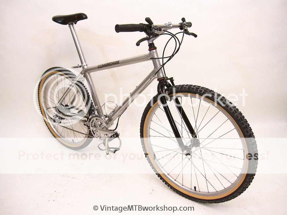

1989 Cunningham
