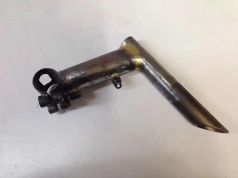

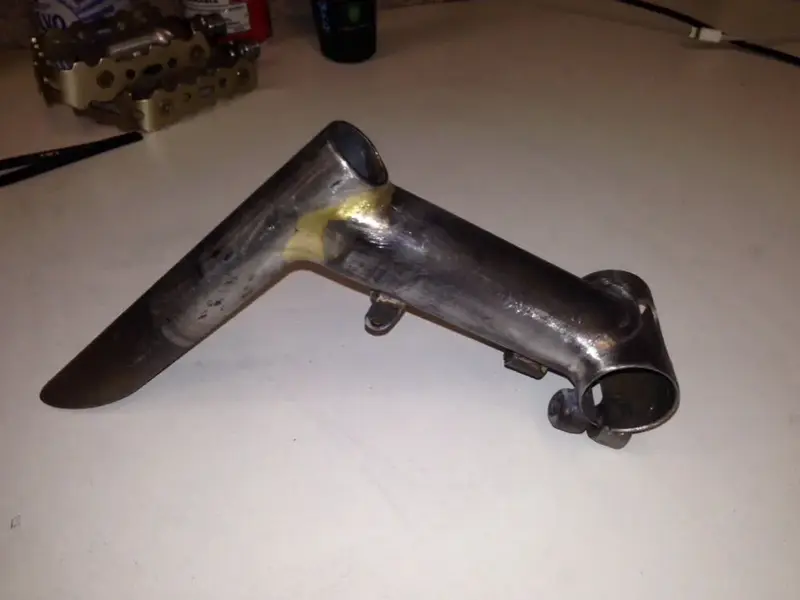

As I'm no longer 17 with an elastic back, I needed a more forgiving stem, I couldn't find one with the angle or length with a double clamp, so I chopped up two stems to make one !
So this part GT part Kona Velocity so still retro ! :D

Re: Overbury's Pioneer - Built in Bristol runs like clockwor
Mate, you need to bugger off, chopping and re-welding stems.....
How the F are the rest of us going to keep up with you?
Seriously, top top work, I doff my cap
I can take credit for the chopping up but I required the talents of someone more skilled than I with the brazing! :D

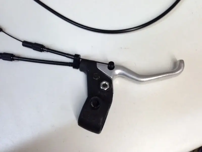

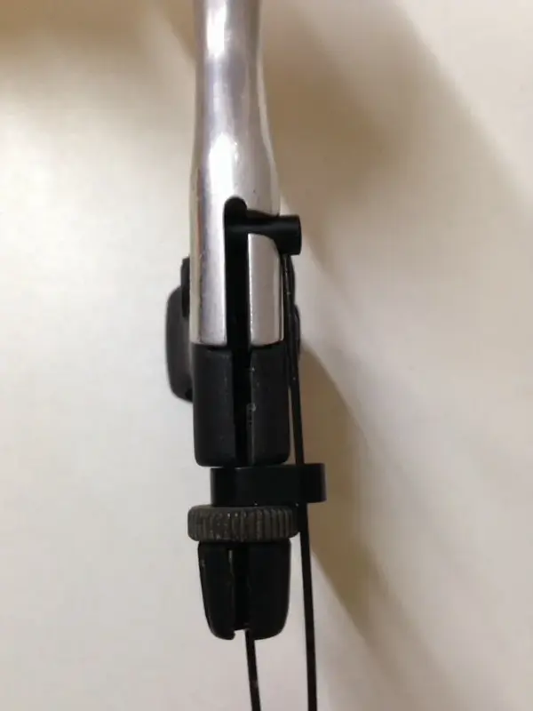

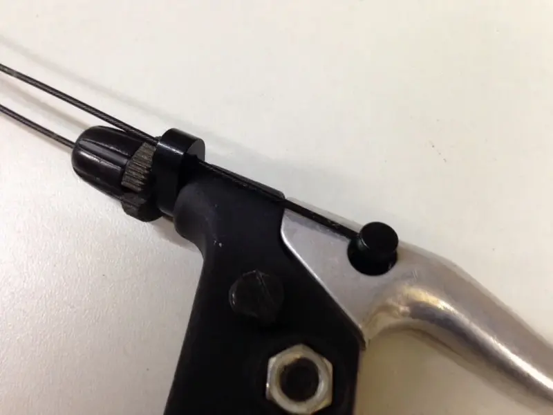

Think I've managed to sort the brake lever problem out, I found a company in the states called Fixcraft who specialise in bike polo, they do a short pull brake cable kit with a dual linear cable :D
This fits a standard cantilever brake lever, the adjuster and nut will need to be remade smaller as the cable ferrule won't fit at the moment but with a bit of tweaking it should work, the kit comes with inline adjusters for the front brake .
Might have to look out for a an xt lever with the rubber hood to finish it off, the kit was only $27 and with shipping cost about £20 if I break it tho I've got a long wait so I might have to get a spare ! :facepalm:
ooh like that, a very elegant solution.
