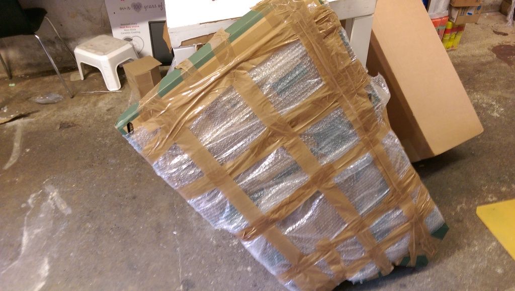

So I finally snagged one, and in a good size too ever since seeing LGF's orange/grey pioneer I knew I wanted one. Saw this on ebay and made some inquiries about the condition and whilst chatting seller kindly made a price suggestion and offered to post too so as I just sold a house, I thought I would treat myself.
Well, it arrived and it as the photos suggested.....its been boxed by a greengrocer :lol: otherwise its quite unloved, bars were buckled, u-brake faded, headset a mish mash, V-brake...yuck, 200GS rear mech :| but the canvas is all there, seatpost & stem came out no problem and will be binned so now its just bottom bracket playtime tomorrow(gotta do this at work as I wasnt allowed any more bikes :oops: ) so now its just finish decision time, colours? stem?, probably going Deore DX again........ anyways, I love bringing old bikes back to life and I'm gonna love putting my touch on this too. :)

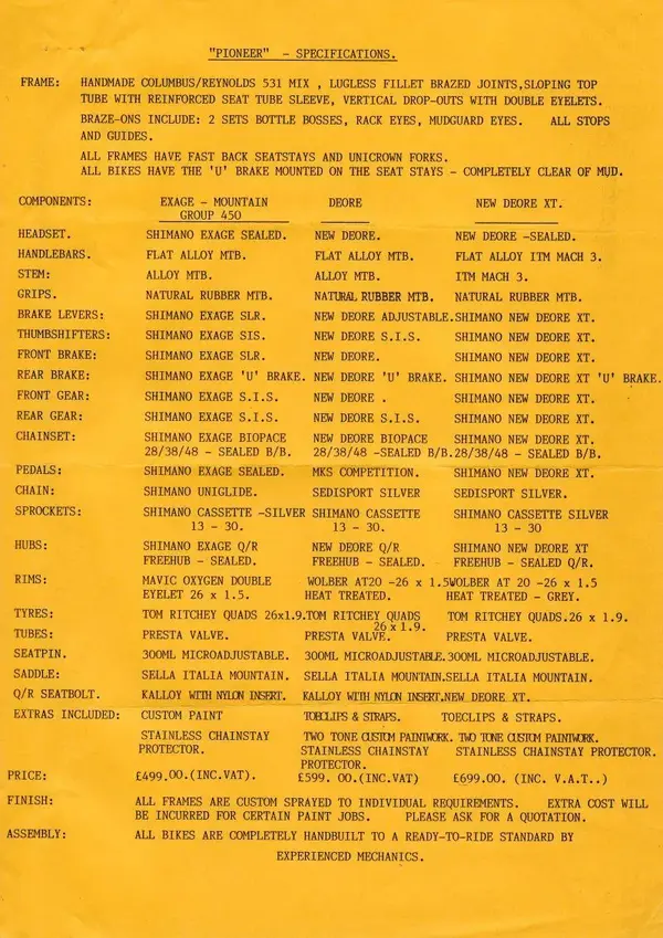

They were pretty much all custom available with Exage up to XT depending on budget.
Here's some 1988 documentation.....
