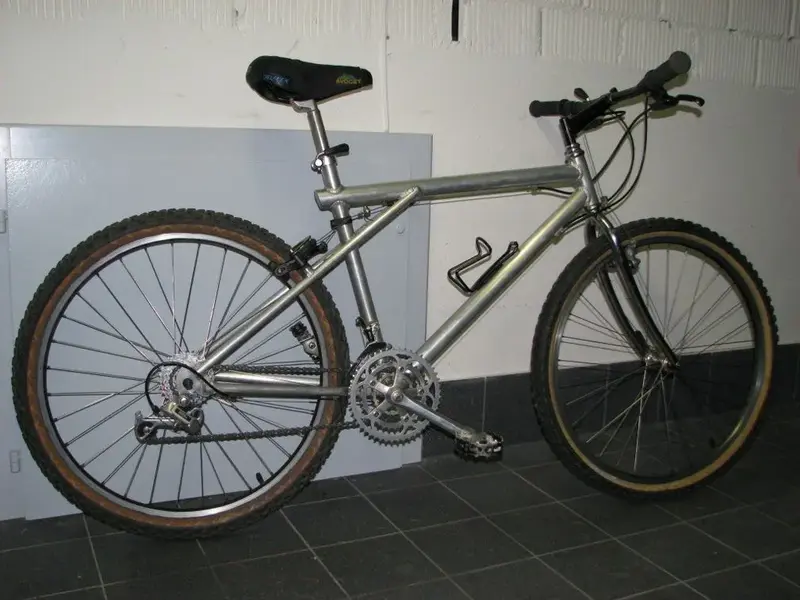

my own Fisher - some builders used extrusion with no reinforcement rings

this below must of been genesis for the zaskar in the mid to late 80s, i read that all the ones made cracked and failed and the bike in the picture is the only one left in existence. im guessing that GT threw a bunch of burly gussets on it for strength, neatened up the welds and it evolved into the 1991 zaskar.
