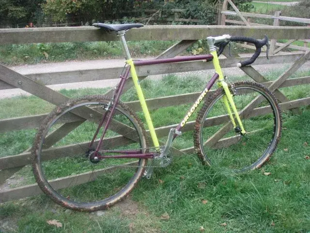

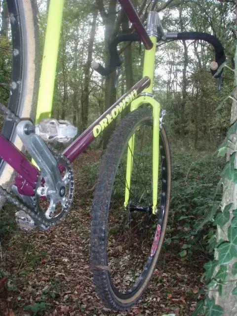

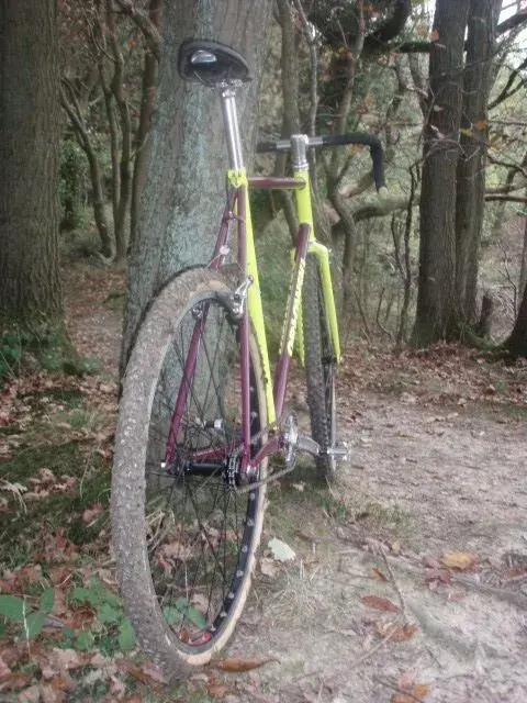

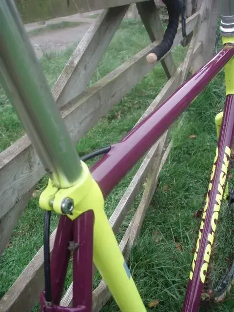

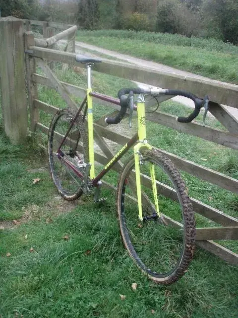

First proper offroad ride today. I started a bit tentatively to say the least as my first dirty outing since I broke my wrist. My initial impression was that the bike was very tall and I worried that I'd messed up the sizing (usually bikes tend to be a little low). However once I relaxed and hit dirt it all really started to come together and I found it very comfortable riding in the drops (the extra couple of mm on the head tube paying off perhaps?). i also found that I had surprising confidence for a first ride although that may have been the conditions, soft but not muddy with a good coverage of leaves - with the latter I was certainly glad of the very wide clearance I'd spec'd as it didn't clog up once.
I probably need to true the front wheel and replace the bearings in the rear (ok, I really should get myself some new wheels rather than use this 7 year old pair that I got secondhand) and I may fit some Sram S500 aero levers instead of the Shimano 600 tricolor but otherwise I'll just ride it as it is.
Oh, and a few photos from today.....

And a couple more....

Actually, one thing I did forget in the speccing was to have rear brake on the left (the internal cabling rather decides which brake goes to which hand), not really a problem as I have a few road bikes with a similar set up and it caused no issue today but highlights the need to take into account every detail when placing the order.
