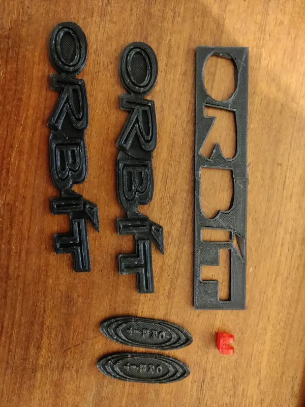

After wasting much 3d printer filament ive got the basis for my decals done. All need some fettling, moulding around the tubes and painting and gold leafing.
Dad was a miner for over 20 years so carbon black with gold leaf tops seams quite apt for coal and iron pyrite.
