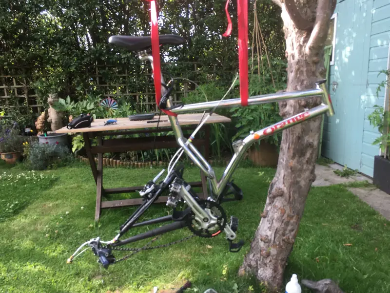

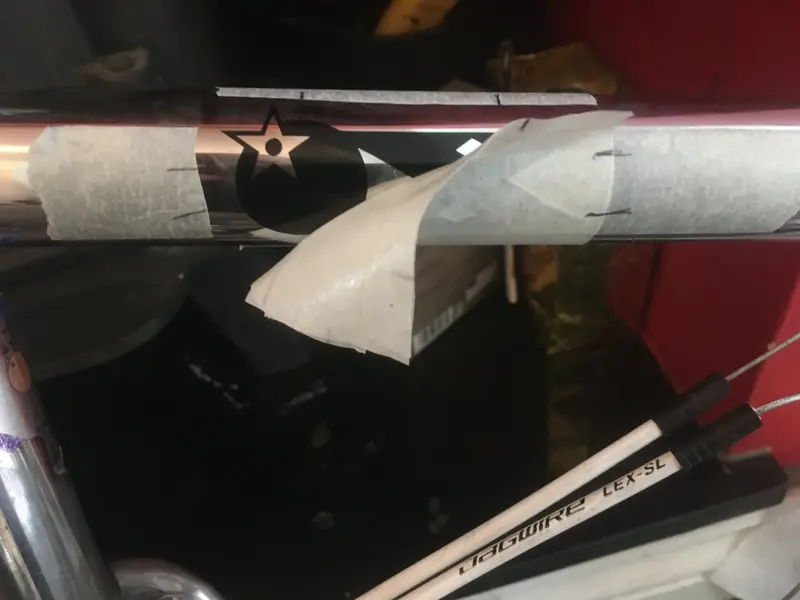

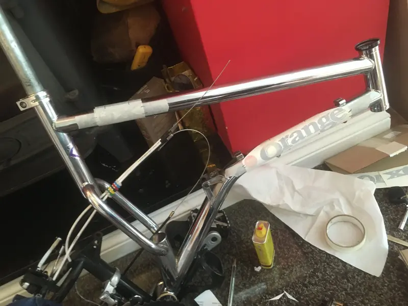

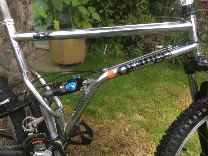

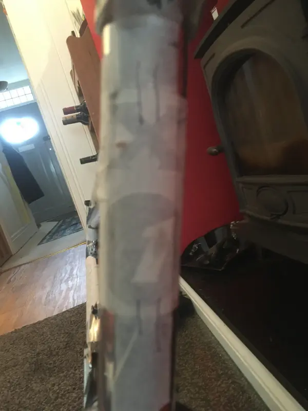

Just thought I'd post an update on where I'm at for anyone who's interested. The seasoned retro-fitters are right, PACE RC36 seem the best option for forks. Watched a few on eBay but couldn't part with the cash so i'll keep an eye out for future. Plumped for shite Zoom forks w. 1" steerer while the 'Judy's' went to a mate to see if the damper cartridge is any good & so worth keeping. Hope so, the Zoom are really shit. Needed a new headset too. Found an original stem on eBay, my 1st auction win! Ever! & got the 'new' Shimano XT shifter/brakes on, & they're f**kin great. & Thanks to RetroDecals for the...retro decals
