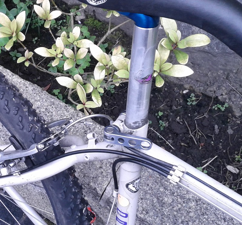

I have been scared by a few posts on here warning me not to use a QR on my clockwork.
I need a barrel bolt?
This is my clamp, is this a barrel bolt?
One side is a nut, the other is a collar which has a round allen head bolt head in.

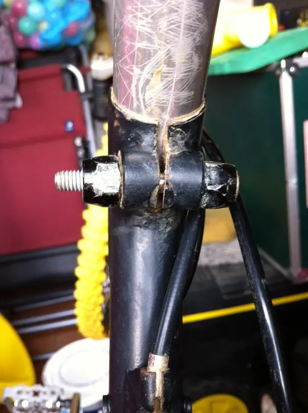

This was mentioned in another thread, and I'm not sure the one in the first photo is correct. The second one is what I have just received from st John street cycles - a campagnolo seat pin.
Now I have it I can see how it works - there is a none-threaded bit on either side that fits snugly in the holes of the seat clamp. Instead of exerting force from just the outside and bending the clamp inwards, it encourages a parallel drawing together of the two sides. The internal, snug-fitting threadless bits don't allow pivoting.
Just my observations. Sjs was the only place that had them - about 9 quid.
