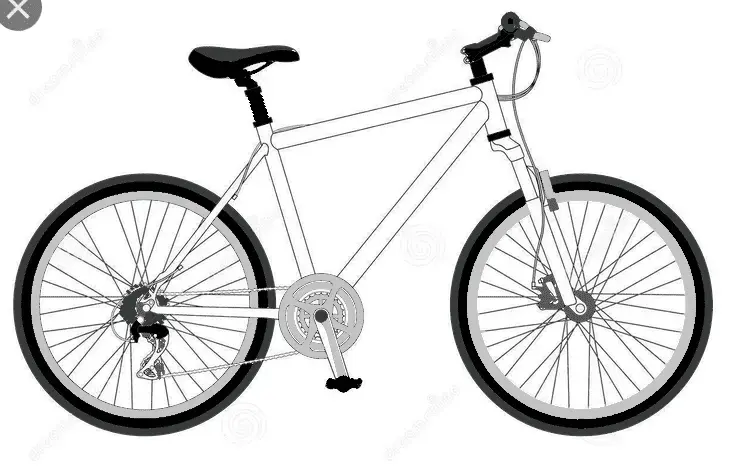

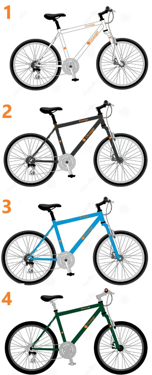

I'm turning my attention to the frame, after my mate has given it the once over I'm going to tear it down and send the frame to the powder coaters, I am still undecided on colour though, it's currently black but I already have a black bike and fancy something different, I have ordered a set of replacement decals so it needs to be something that goes with orange. I have mocked up some ideas, all the colours are taken from what was popular in 1992, although none are classic 'Orange' colours.
Here's what I'm currently toying with...
1 - White
2 - Gun metal
3 - Electric blue
4 - Forest green
What do you reckon? The template shows front shocks but ignore that as mine has rigid forks, I'm also open to suggestions and here's the blank template if anyone wants to have a mess around with it.

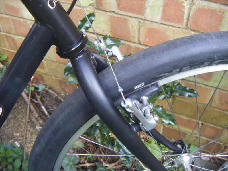

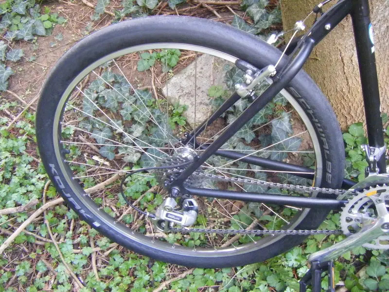

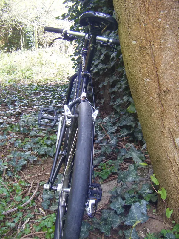

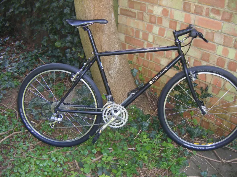

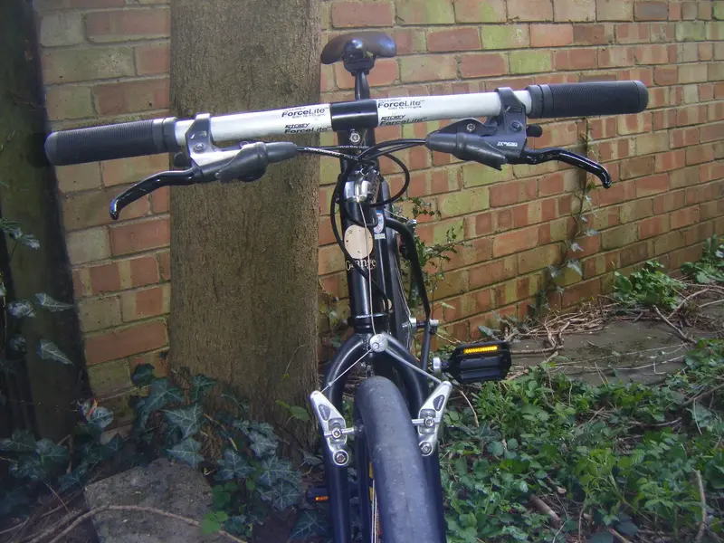

Got some pics, the bike needs a new crank set, I also bought a new cassette as the current one looks a bit worn. but apart from that all is good. I stuck some slicks on it primarily because the psycho II's seem a bit unreliable, although they look almost entirely unused, the gum walls are feeling a bit papery.

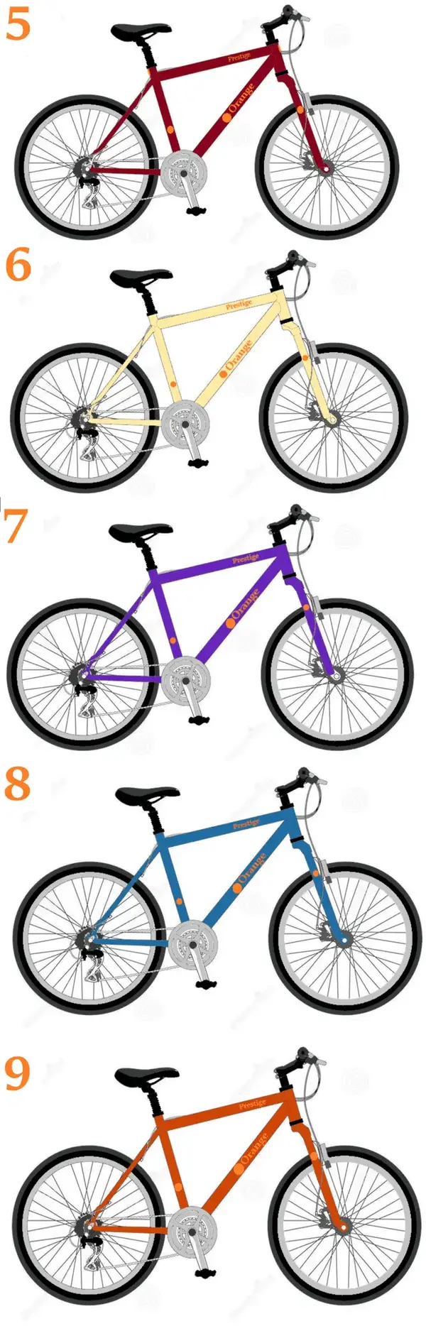

I also came up with a few more colour schemes, although I am beginning to lean towards keeping her as original as possible, some of the decals are in a terrible state and there's a point where keeping it original means keeping it looking tatty. See how it goes.
5 - Blood red
6 - Magnolia
7 - Purple
8 - Petrol blue
9 - Dark orange
