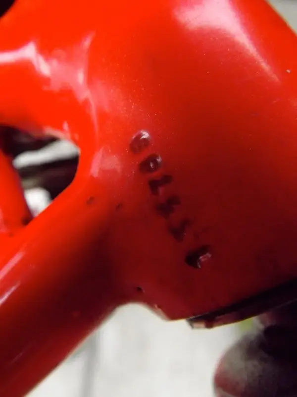

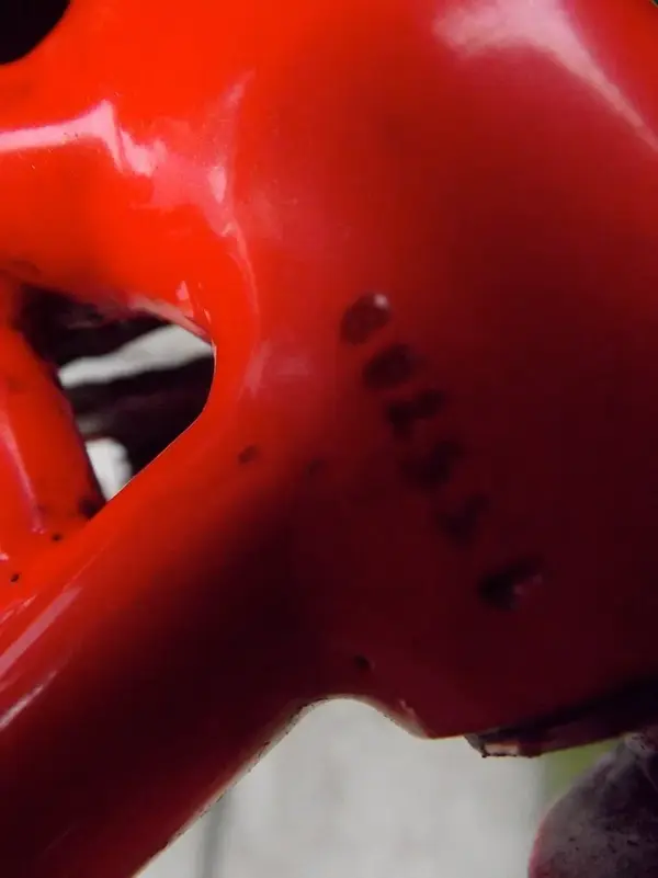

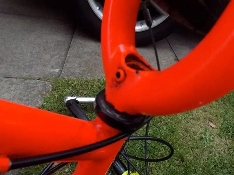

Orange. . . . .Formula?????
more....

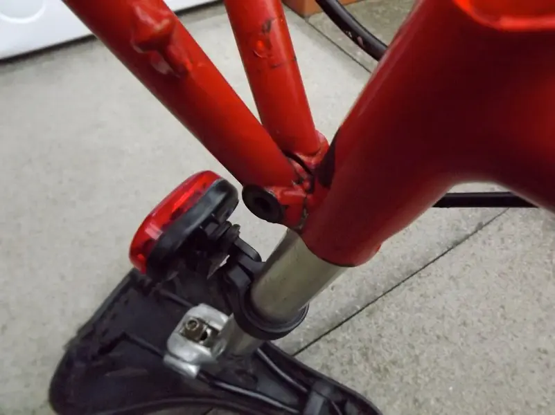

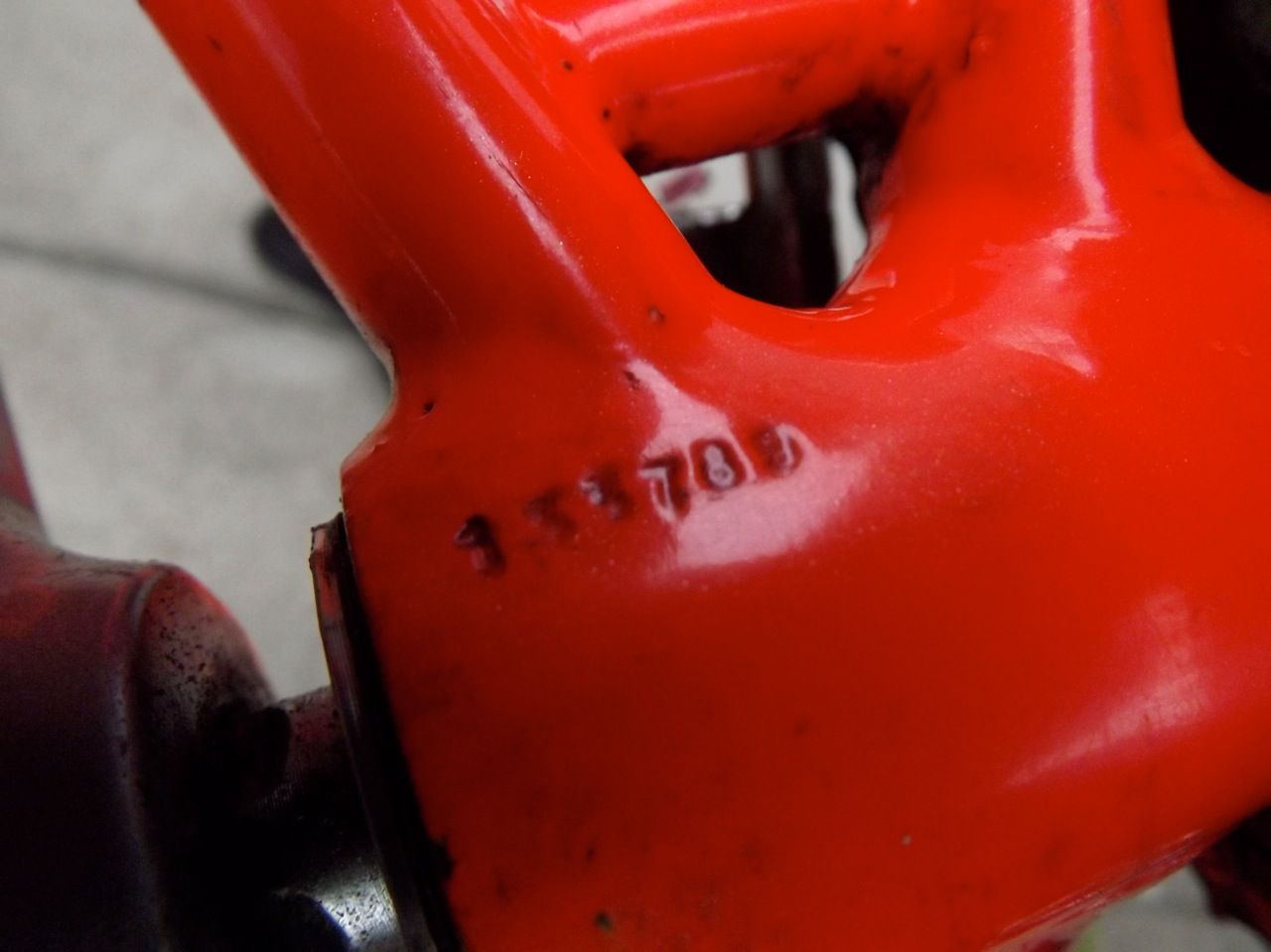

I don't see anything there that would worry me personally, it's pretty much as you would expect for the age.
I thought that. Its a old steel frame and I do not understand the whole "ooo its a formula malarkey around it.

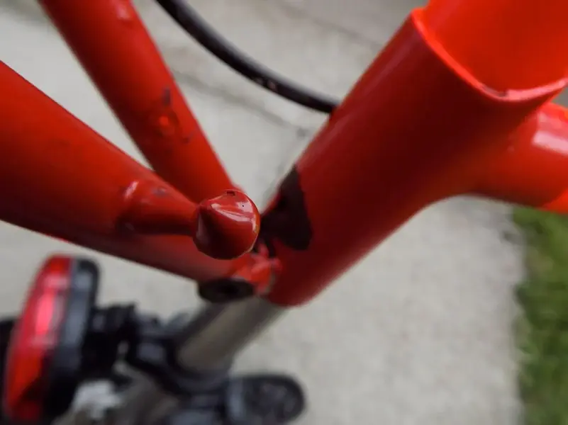

Only if you were buying a beat to shit bike, for 1000 beans plus you would expect a bit more despite the rarity of this outsourced frame.
Now i am not one to shy away from 'challenging' bikes but at the end of the auction all that is truly worth bothering with is the frame and forks and that frame has some serious issues that will need some decent money throwing at them; the fastback cluster is a mess with the heavy rust and cracks and will likely be more so once that seat post is burnt, yanked or cut out. Once the post is out the extent of the rust in the seat tube can be checked and this is where there is a massive gamble on the part of the buyers replacing that tube would be fun especially if you wanted to keep that embossed orange at the top. The cable guide on the BB looks to be cracked (as a load of those did after years of use) so would probably need sorting. And after all that what do you do with the paint-nice to keep the original but will that be possible with all the brazing, welding and stuff going on. Finally, what is going on with this fillet; one side semi reasonable, one side a bit of a lopsided monster:
That would assume I would pay a grand for this bike ...which I wouldn't
i'm glad i was out at £500.i would have been buying it to ride and then maybe over winter sent off to argos and put some decent kit on it.i wouldn't have been a happy bunny turning up and seeing that crack,bodged weld and stuck post (bottom bracket looks a bit mangled too,has that been in there 30+ years??)
at no point did the buyer give me any information on any of the faults,also he hasn't updated the ebay ad and people are still bidding - it's just gone over 1000 now.
