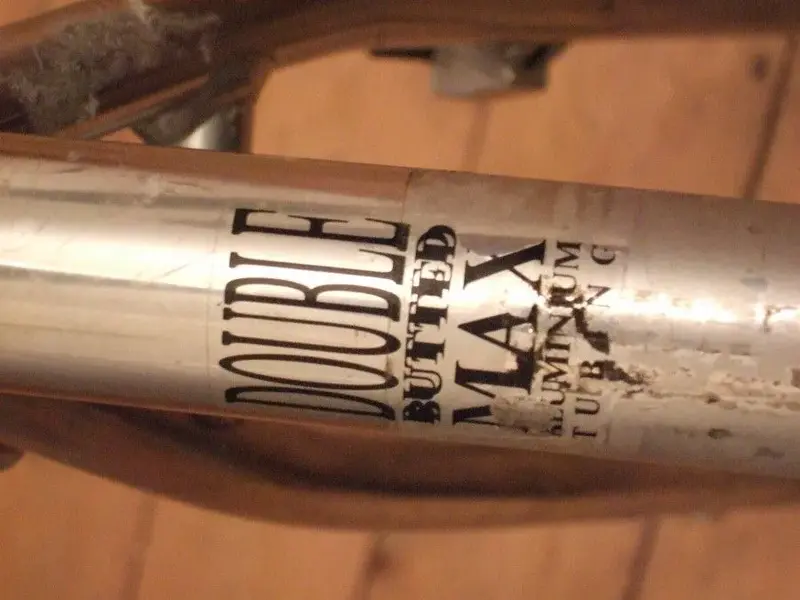

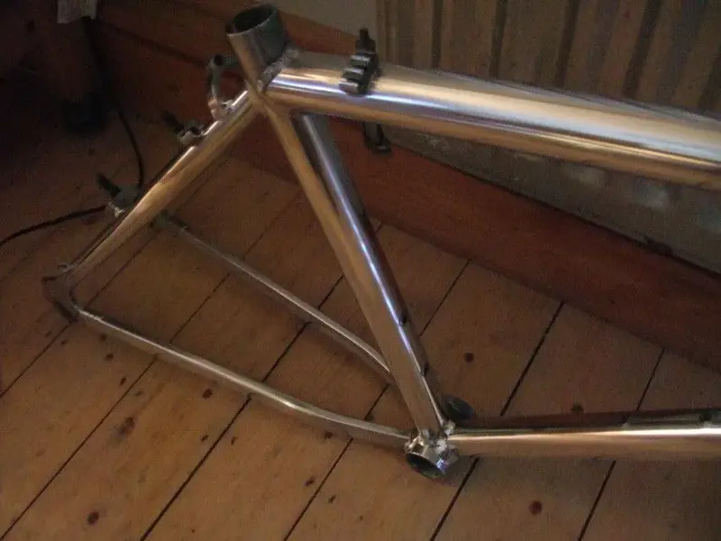

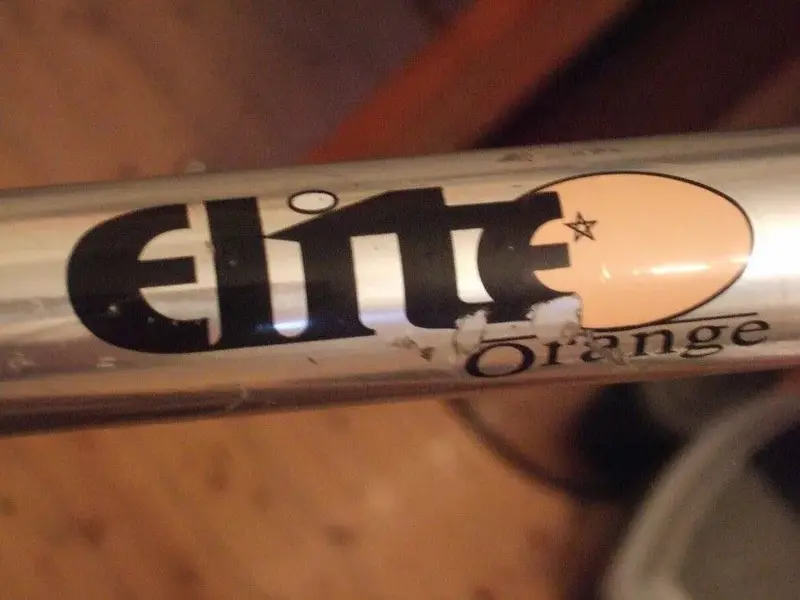

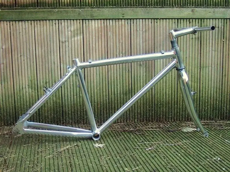

Still ongoing with my 'elite'..... on the 2nd tube of Autosol now! :D
Was the 'elite' available in a gold anodised finish?.... would love to see a pic of one if it was. I thought they were all polished aluminium finish?
Here's some progress pics of mine.... long way to go yet :(
