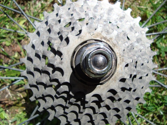

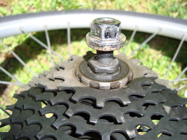

Your freehub body looks like Uniglide only (no inside threads for a cassette lockring). But if you do the freehub body transplant as above, you need a Hyperglide cassette. Which I believe started with 7 speed (no 6 speed*). Which means a new 7 speed shifter at a minimum, as well as the move to 135 mm OLD (axle, spread dropouts, chainline, etc).

I havent read all of this but a quick glance at the pictures leads me to think that you have a 7 speed width freehub body there anyway.

The transplant of the Uniglide freehub body took about 20 minutes and while I was at it I swapped to quick release axles. It now has a 7spd cassette body which extends its useful life for the next upteen decades or until the world's supply of 7spd cassettes runs out - which is a bit like oil, either 40 years or 140 years depending of whomever you believe.
That would leave the whole MT060 gearing alone too. You adjust the rear mechs' reach to take into account the extra width. As above, theres a 7th indexed click on the thumbshifter and the spread is enough to shift across the whole cassette without too much issue.
