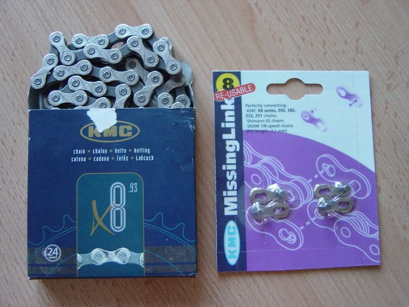

They sell them as reusable ?
Note the red balloon text on the link packaging.
