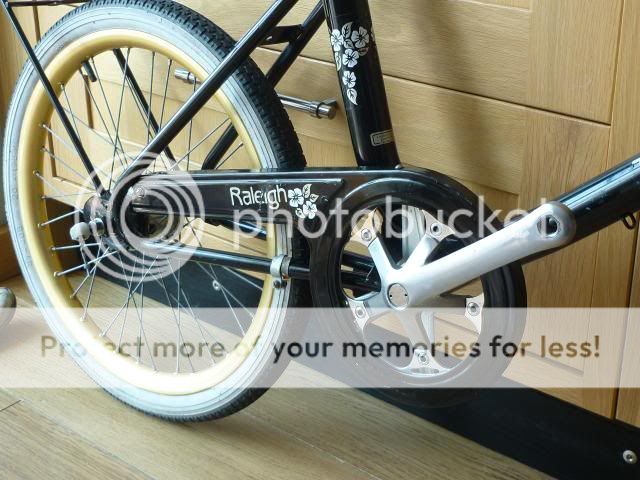

I found an old Shimano 400EX crank and tried it all on for fit. Works great even with the chainguard.

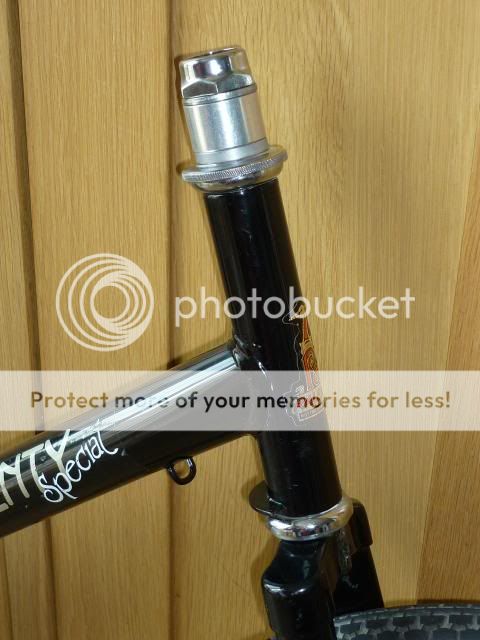

Polished up the frame and regreased the headset, replacing the clamp with a huge spacer as the new stem is quill fitment.

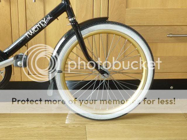

This is about th twentieth (appropriately) time I've snuck on here to have a peak. Those gold Araya rims are absolutely incredible. This could look smashing whenit's done.

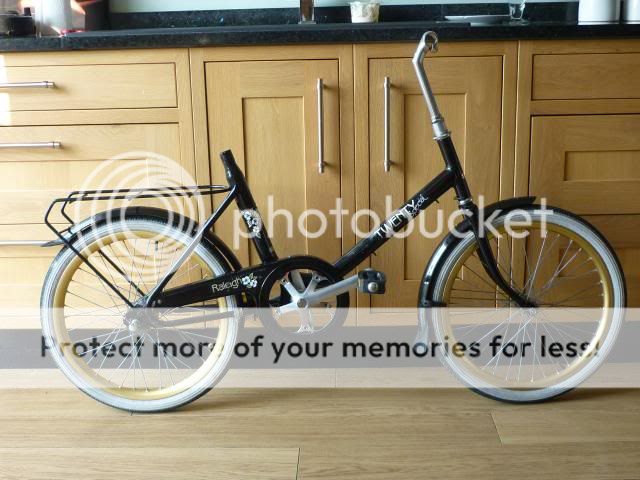

Progress report:
How it's looking now:
Cleaned headset with lamp bracket and clamp removed:
Shimano 400EX chainset (lightly polished) with polished 46t TA chainring and stainless steel dust caps. Sealed VP bottom bracket.

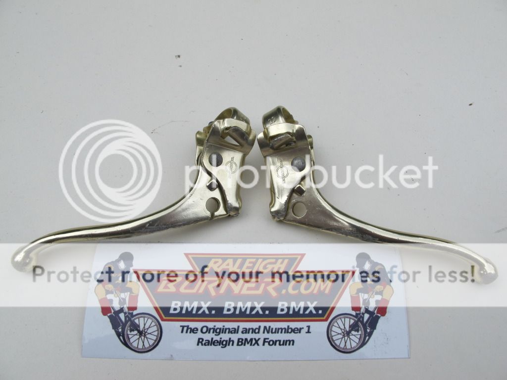

i have one of these if you want it:
think its the right hand side (front brake) lever. needs some polishing up. PM if interested.
you can have it for postage :)
Brakes are on order fella thanks anyway.

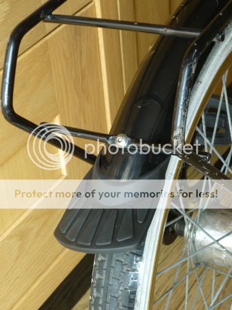

New guards (from bottom - new rear, old rear, new front, old front)
The original rear guard was held in place with a bolt through the fixed rack. I thought I was going to have to drill it but the new guards had a rivet holding on the mudflap in exactly the right place, result!

Rear guard:
So far:
