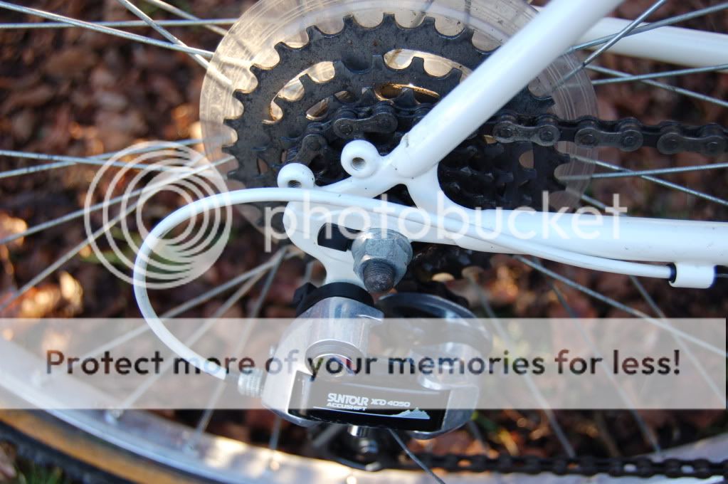

This bike has a sloping top tube frame with 70/73 geo and whilst i accept this is partly due to the size, Araya did "deliberately" make two forms of mtb, sloping and flat TT, back in '87-8.
According to Araya data this is 420mm c/tt (which is 16.5") for their sloping frame design (or 18" kona sized!).
A Japanese made Tange Cro-mo frameset (wow! (assembled in taiwan mind)) with mid-range or better components (suntour / sugino / sansin co-op) but a 'british' company and they (he) ride(s) superbly. It has Sugino Cycloidal Rings (aka biopace) too.

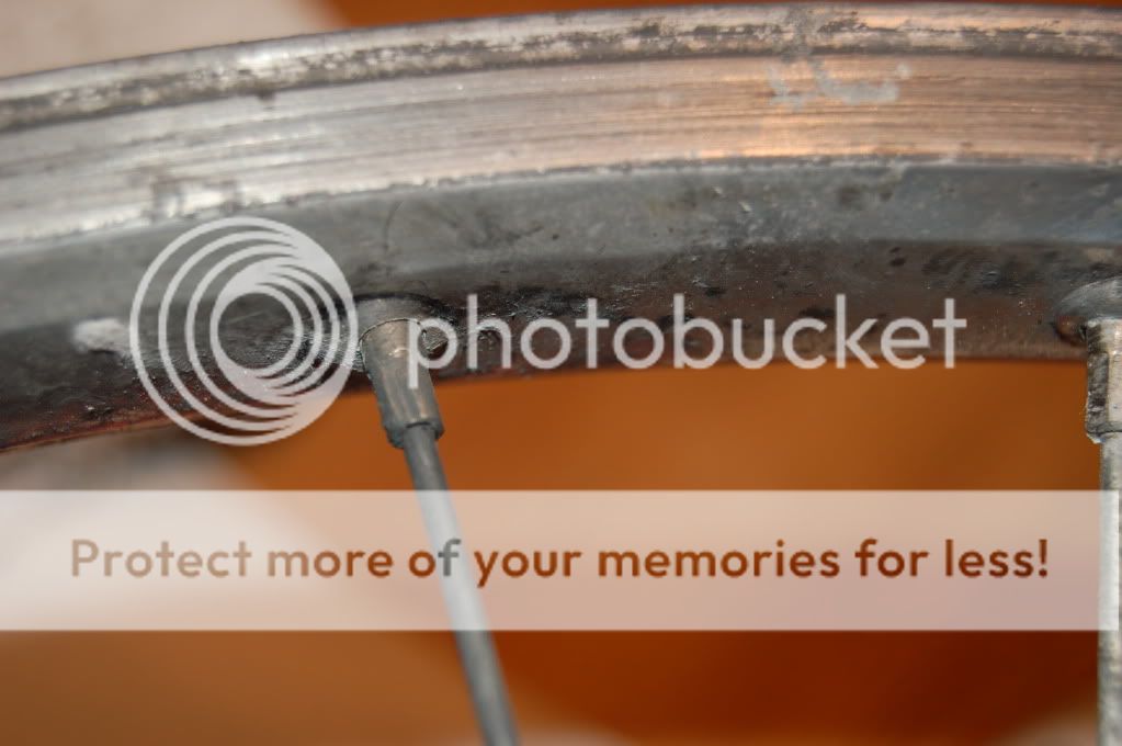

Anyhow i've spent 20 hours cleaning, stripping, de-rusting (spokes), polishing and polishing again, the wheels.
This is what 24 years of condensation and cat-wee does for Araya rims... :shock:
A shot in progress - the inner rim was cleaned first (under rim tape & clincher edge), using wire wool and then polish, then the rim edge then the braking surface then each spoke (36 x 15 minutes average each) then the flat of the rim and the nipples!
All by hand with ultrafine wire wool, terry cloths and autosol.
