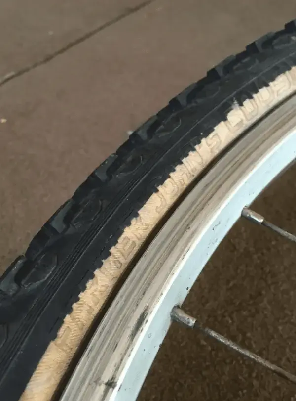

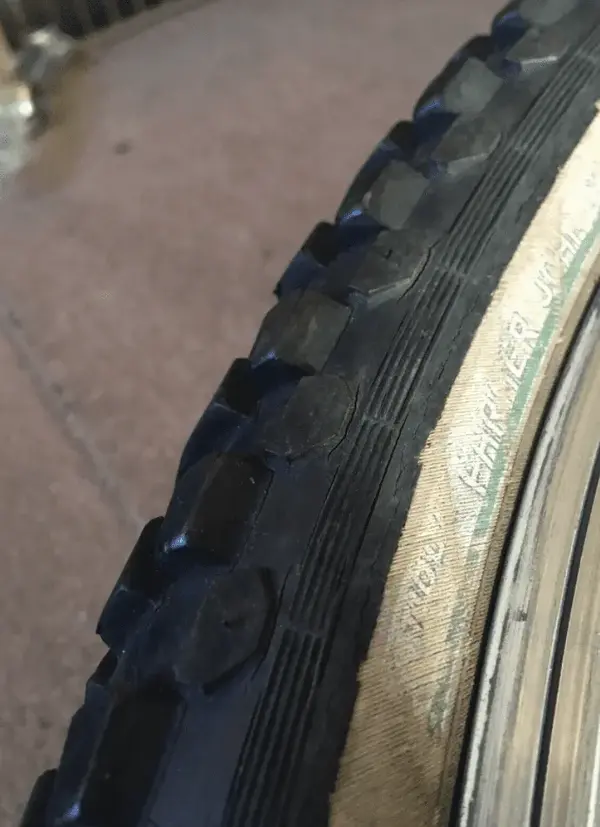

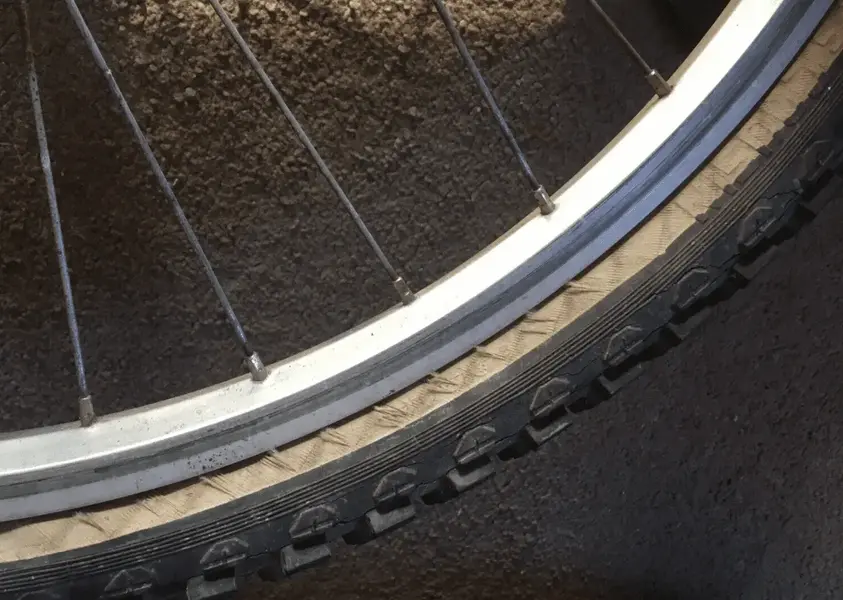

Just sourced and bought two old Farmer Johns, they look barely used, maybe even unused, but of course nothing lasts forever. There's a bit of fraying down the side of one tyre and what looks like cracking on the knobbly bits. I already bought them as I need them to complete a bike and they were silly cheap, but will they be usable?
If they are 'unsafe' are there any steps I could take to reverse the ravages of time? How to care for such old rubber? I remember reading somewhere about baking old tyres to refresh them, is that really a thing?

I’ve gone through 2 tyres in 3 rides where they’d started to fray a little and opened right up very quickly. Ended up binning them and getting some smoke/ darts instead.
Being realistic, 20-30 year old tyres are good for garage queens but not good for riding. The decomposition de-natures the rubber and there's no way to restore it. They are polymerised - long chains of molecules, and when these chains break down you can't stitch them back together. So...perhaps buy some modern tan wall Panaracers or Schwalbe and then have the retro-rubber handy for special occasions....

Yes, I was afraid that might be the case, of course I wouldn't dream of doing any serious riding on any tyres that looked or felt like they might not be stable, but just to see the bike - once I've giving it a thorough service and cleaned, repaired or replaced whatever may need it - dressed in its intended shoes as per the catalogue will be well worth the£15 I paid for them.
Ah ... well we do fortunately have a cool dark place in the workshop, and that’s where the tyres live. That’s where the perfect IRCs were (which were Karma’d to Regan) and the papery and crusty Michelins lived. They do seem to self-destruct at a different rate, even in genuinely cool and dark conditions. Yep...you are exactly right...UV is a big killer of plastics and rubber compounds - particularly black things.

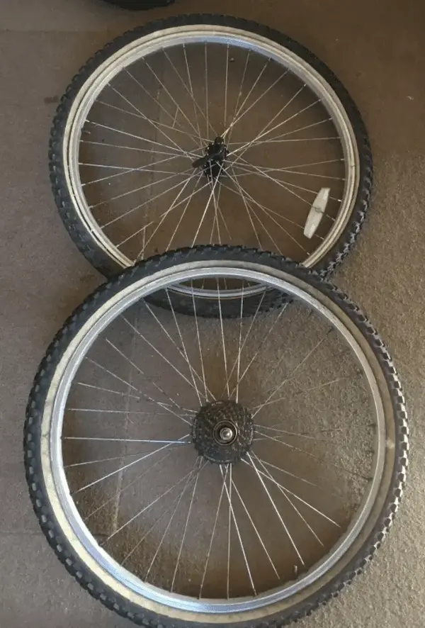

I spoke to the seller this morning, the tyres are still attached to the wheels that the bike came with (a 1987 Specialized), the previous owner immediately upgraded the entire wheelset and so they were never used except perhaps during a quick scoot up and down his driveway. Since 1987 they were stored in a garage, the current owner bought them last year and they have been in a store room at his home for the past few months. He removed the tyres from the wheels as I was only interested in the FJC's
Of course I haven't seen them in the flesh as of yet, but it appears that they are unused and they have been stored in just about the best conditions possible, he reckons the fraying if anything looks worse than it actually is, he says the rubber still feel supple, not papery or dry and brittle as old tyres so often do, and that he'd have no problem putting them on a bike. Time will tell just how good or bad they are, but at the very least they'll make for some very nice photographs once mounted upon my new DB. 😉
