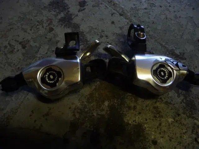

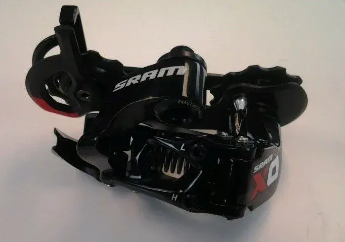

OK i think ive got it :?
Well i hope so.
The 10 speed 2x10 shifters i bought a few weeks ago
And the mech ive just bought. (got a XT 10spd block and kmc 10spd chain)
Its the description that has me confused and Srams site isnt helping, neither is their own compatibility charts. All they show is the parts but make no reference to 1:1 or Exact Act'
I think ive nailed it but i dont know :lol: Please someone confirm or deny :oops: :lol:

Nope - not a chance with those two....
Shifters in silver/black - Mech in black/red
Simply not compatible :roll:
As far as I know - you should be fine - 10spd shifter and Mech - both X0 - TICK
I once tried using a 10spd X0 mech with a 9spd X0 shifter - and noy joy at all.
Cheers :D I was 99.9% sure but just the modern multiple non compatible groupsets had me confused.
Actually the colour is a problem :lol: Im changing from red to purple and muse about the red bits i cant get rid of.
