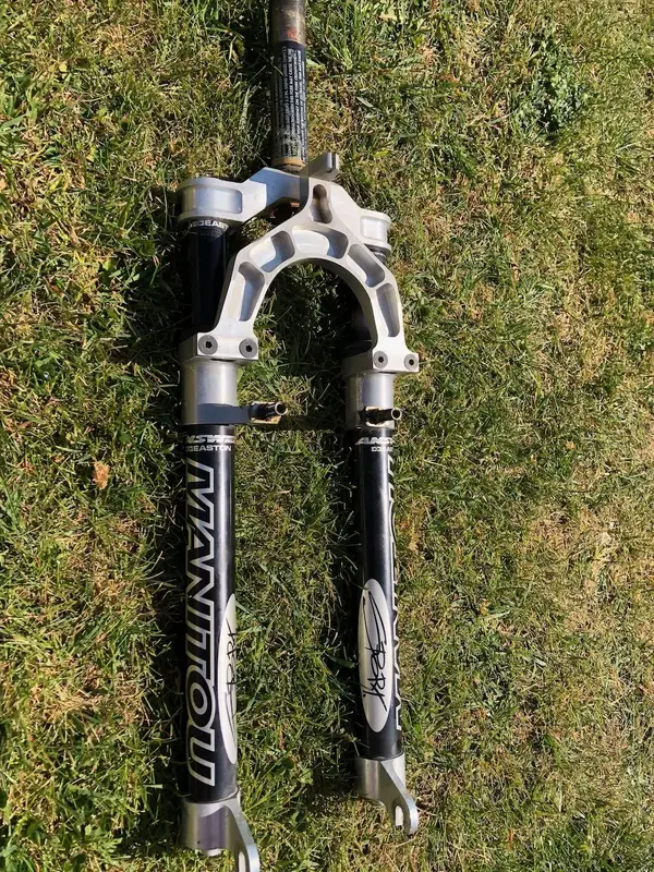

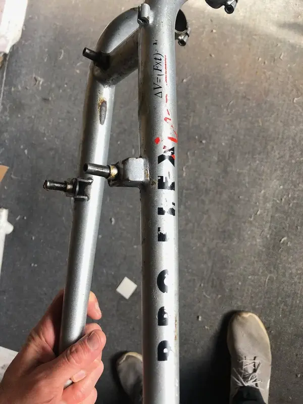

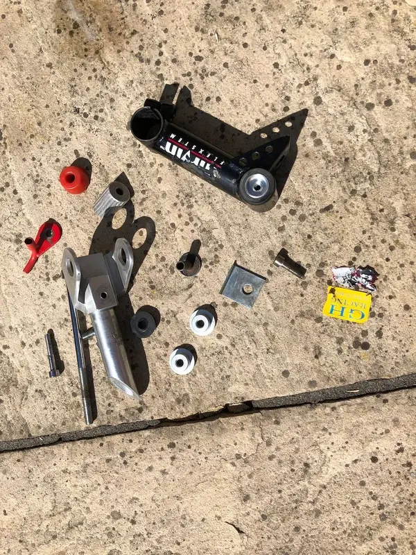

Having agreed with the seller a token compensation for the damage (i couldn't realistically be bothered to ship it back in the current environment) I've cracked on with the tear down...
Tearing down and paint stripping the flex stem...

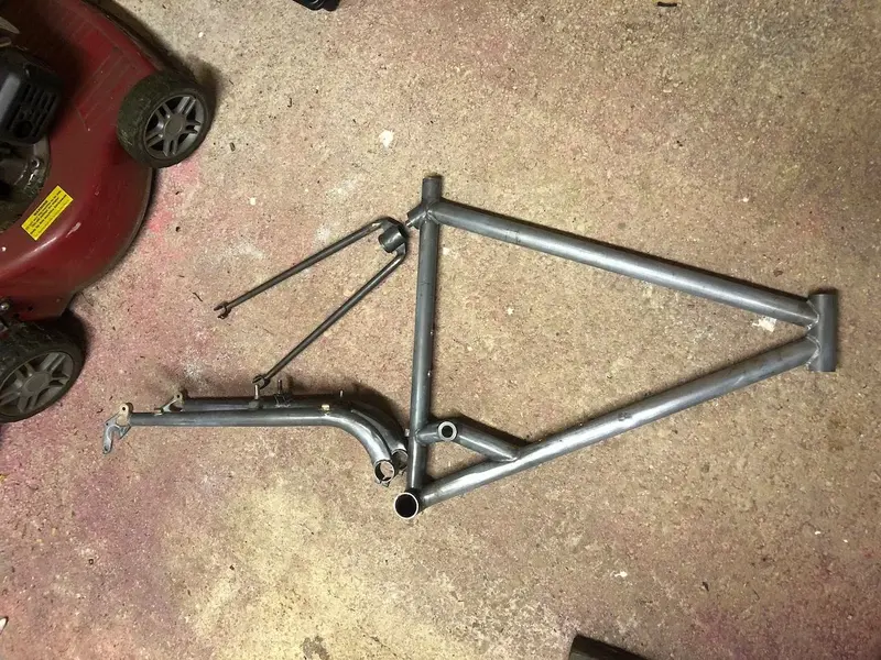

Go the swing arm off without breaking any bushings despite making it up as I went along...

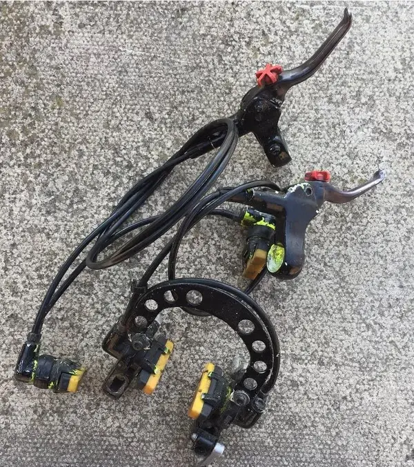

Incoming set of Megura rim brakes that'll need some TLC to get back to there best. My dream proflex had to have yellow Meguras. Won these yesterday for 1/3rd of the price of a (still) yellow pair that also sold in an auction yesterday.

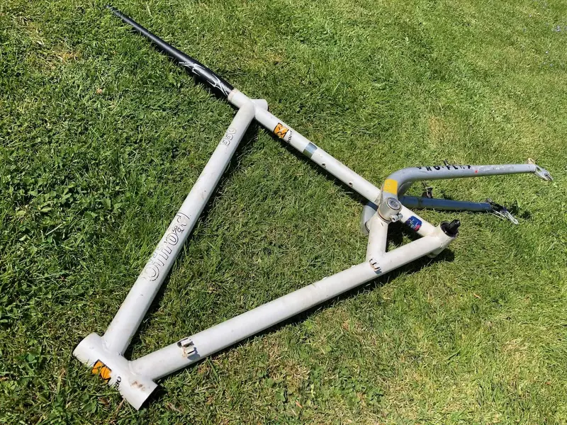

Frame stripped, paint ordered and so are the decals from Gil
