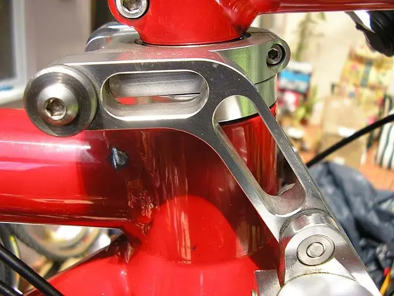

here's a couple more pics of the fork linkage......more to follow.

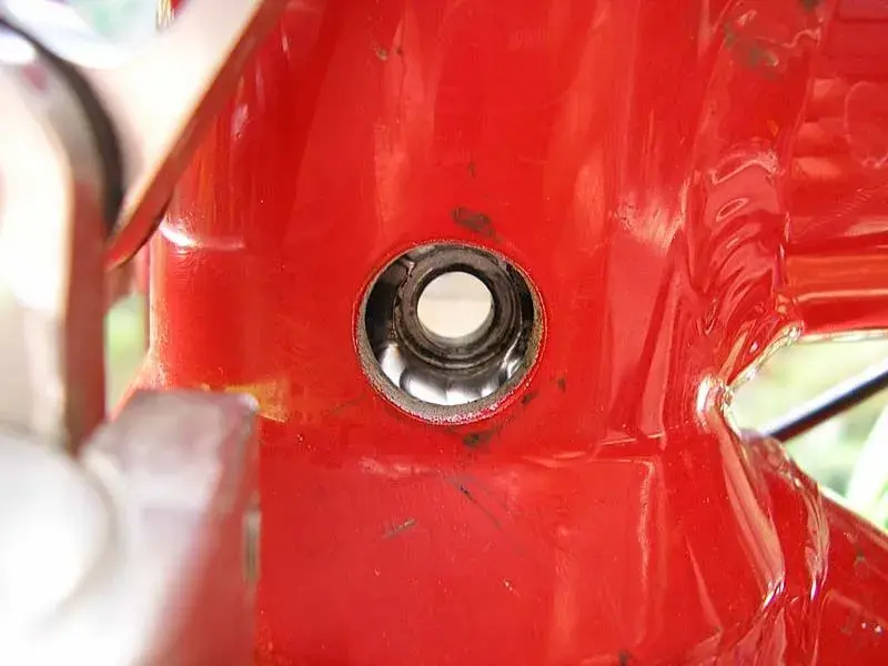

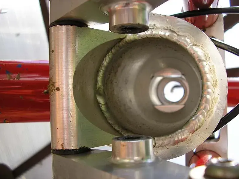

With the shock removed here's a couple of pics of the shock itself, the cathederal like inside of the head-tube and the shock mounting hole in the side of the head-tube. The shock mounting is actually a small piece cut and welded into each side of the steerer-tube.........the steerer itself is, from what I can make out, one piece from top to bottom, there is no star-fangled-nut to add preload.......the whole thing appears to be a press fit :shock:
