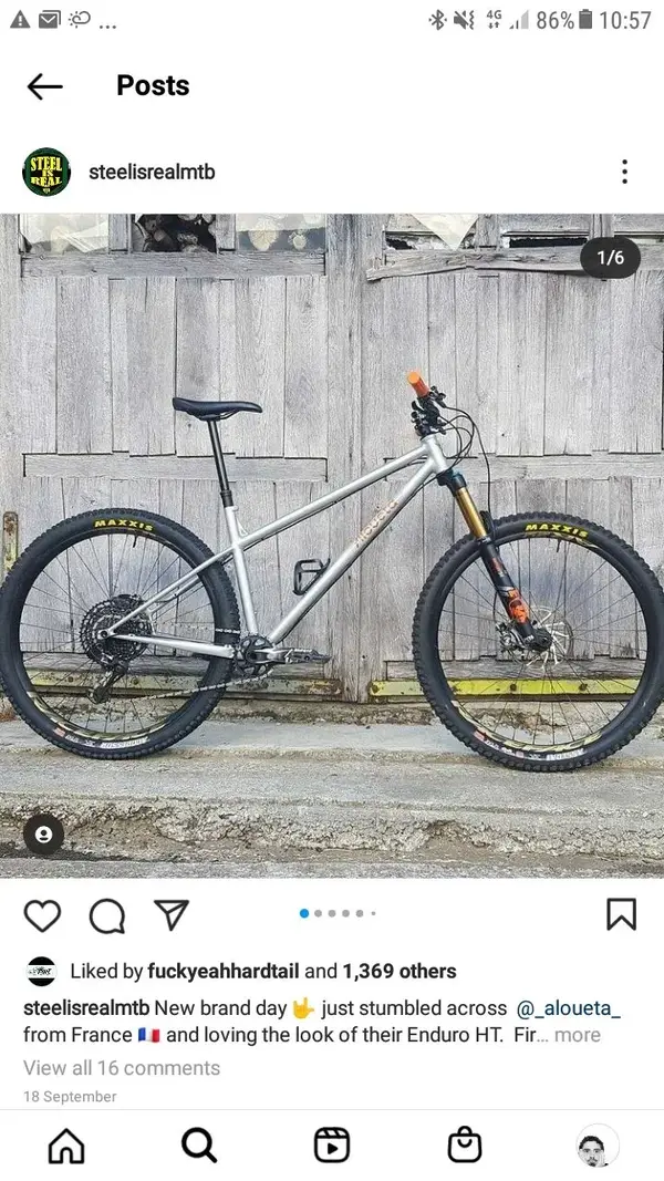

whilst I do appreciate a modern geometry when done well (in this instance I'd say it's pretty well done) I sort of think they look broken. The steeper seat tube and slacker head tube always make the bike look like it's been bent in the middle. This is even more pronounced with the S style down tube.

Its geometry like the bike below i think looks broken. I think it's that the extended triangle made by the fork and seattube angles moves to being in front of the back wheel rather than somewhere over the back axle. Very steep seat tube because of the short chain stay and to keep a decent bb to seat ratio for decent climbing. Don't get me wrong, I'm sure it rides fantastic and looks don't really matter, it just hurts my head a little bit. (best image I could find in a rush)
