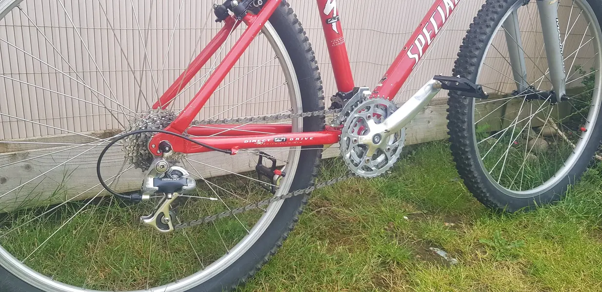

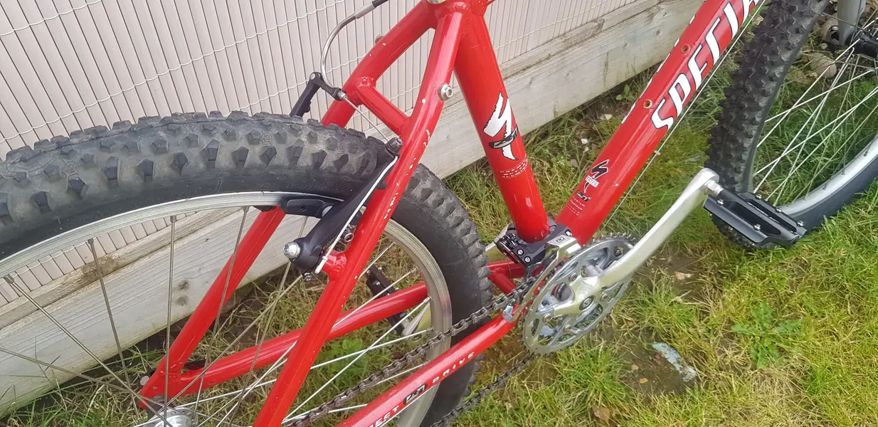

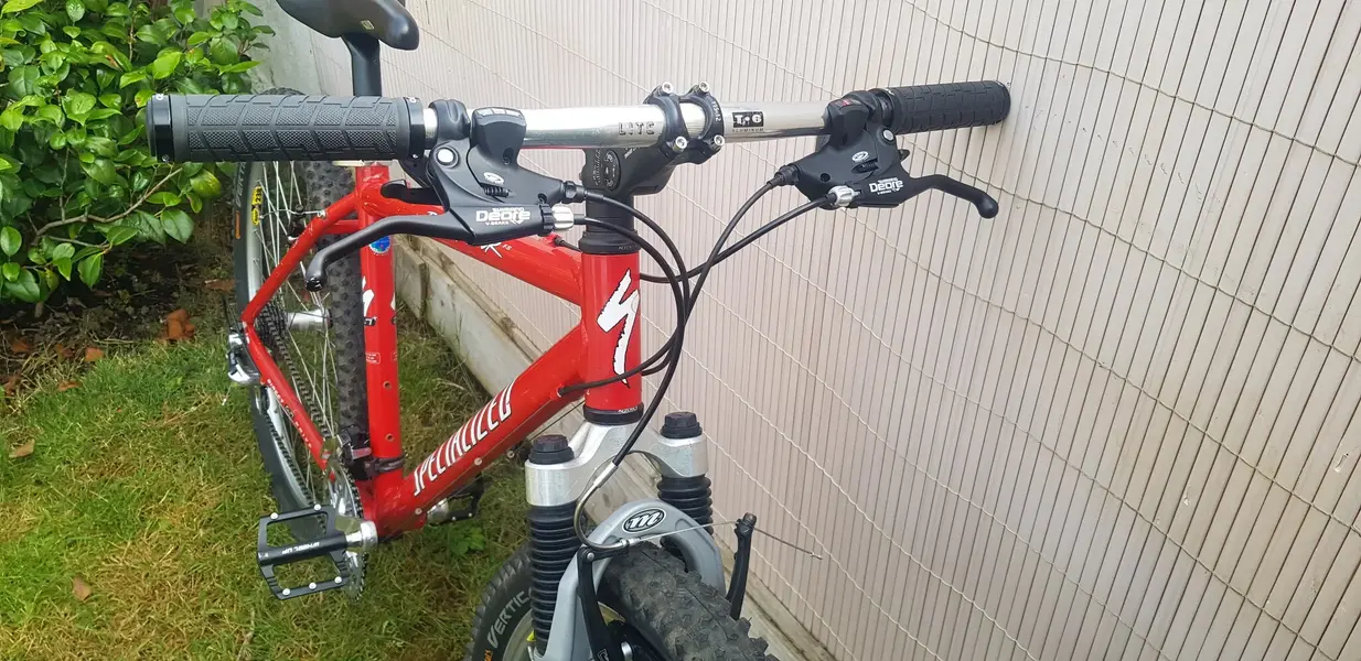

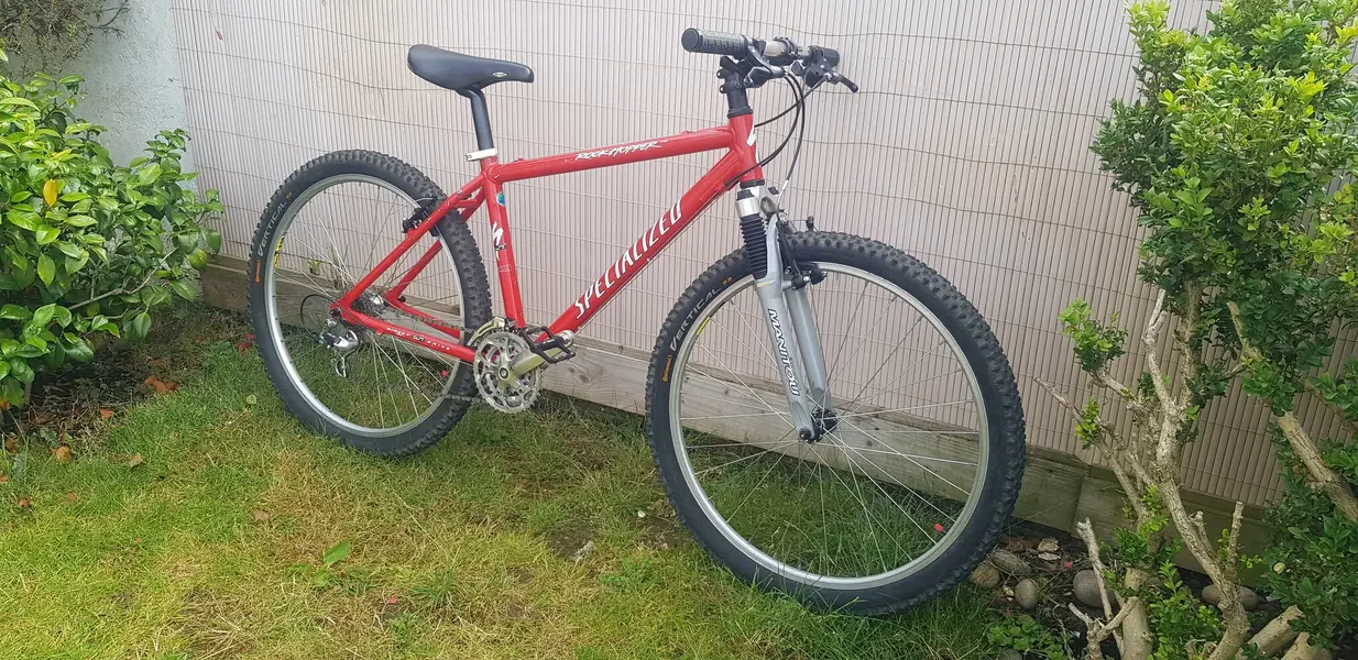

Shortened the chain and it works perfectly now.
All finished and yesterday I went for a test ride.
A lot better than expected!
It glides smoothly and shifts beautifully.
Even the brakes with cheap pads are great!
Thanks everyone for your help!
Here are some pictures 👍

I'm pleased to report that despite an initial rejection, my 12yo boy tried the bike and loves it, especially the gears that on his existing ones are the revoshift.

Nice one Jimmy, the only thing I would change is the stem. If you found a comfy position and can get your hands on the right one it wil look a lot better and save you a few grams.
Oh and you can put the brake cables behind the brake arms, there is even a little hook for that on the brake. I think you have cut them just in the right length .
I think it needs shortening, but I await your verdict.
I think you have a 'medium cage' mech which might be slightly limited in its overall tooth capacity - what cassette and front chain rings are you running (in terms of teeth)?
I would NOT shorten the chain personally - it looks about as 'tight' as I would be take it on the big/big, but it is obviously not taking up tension in the smaller higher gear sprocket combinations which sorta suggest you need a longer cage mech for this setup
