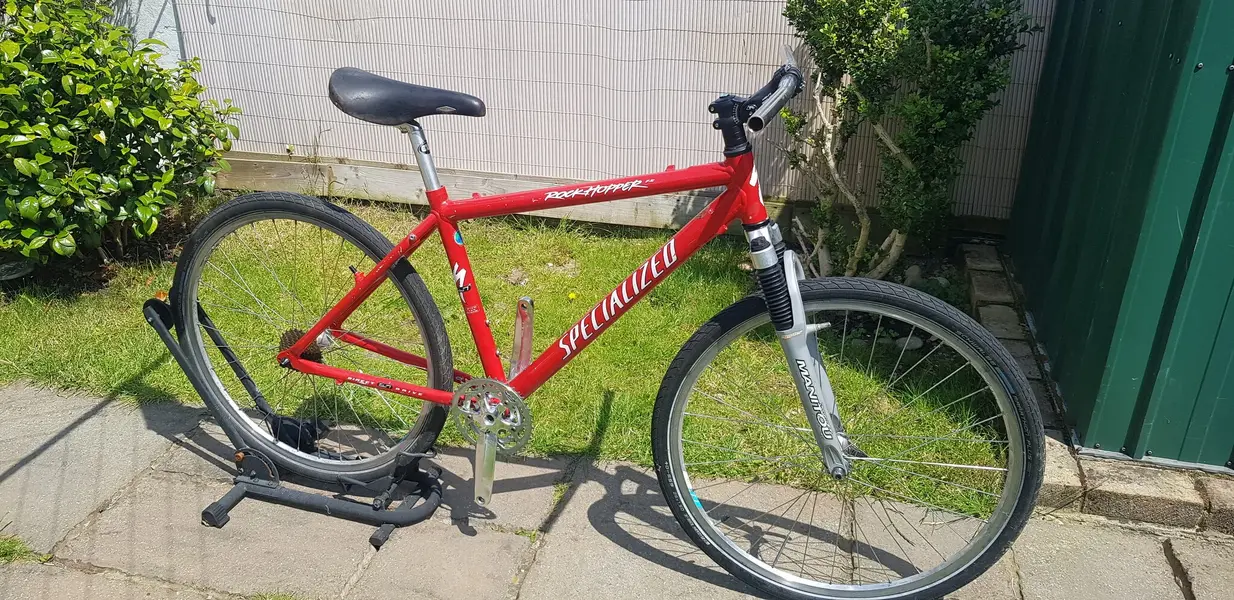

So, here is a frame that a guy gave away on gumtree along with a Manitou Spyder that I took from another bike.
I cleaned the frame and fork

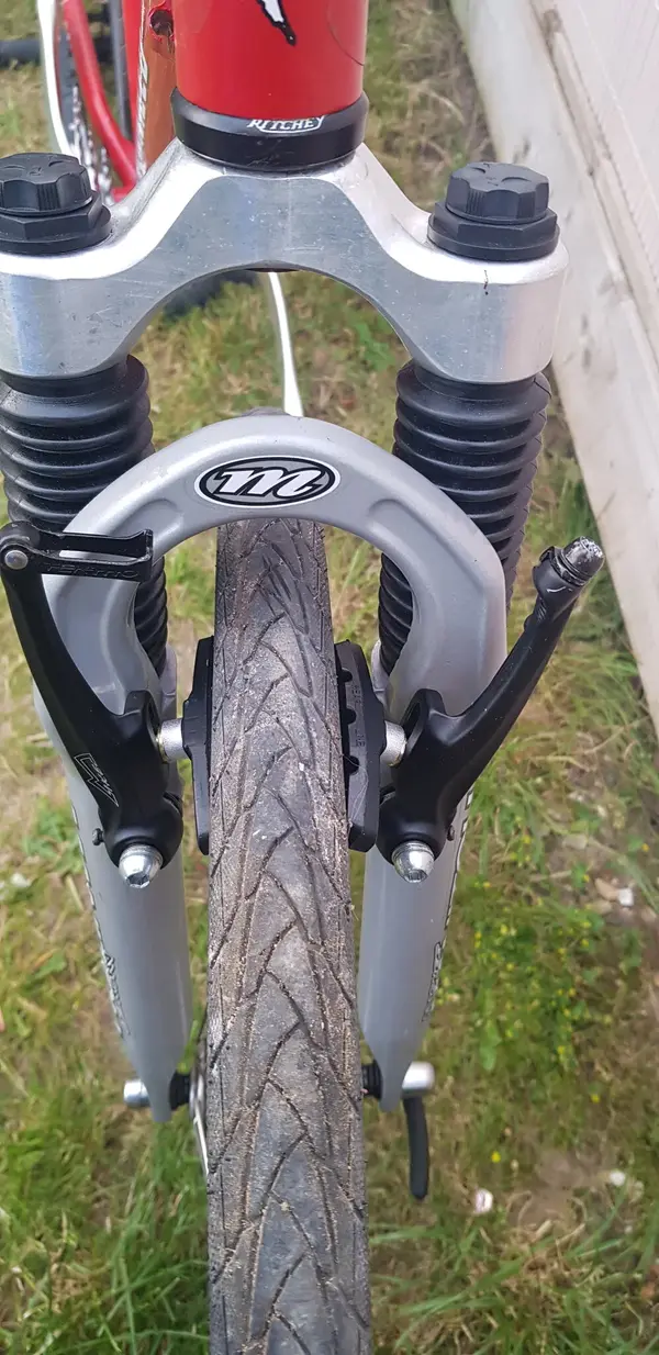

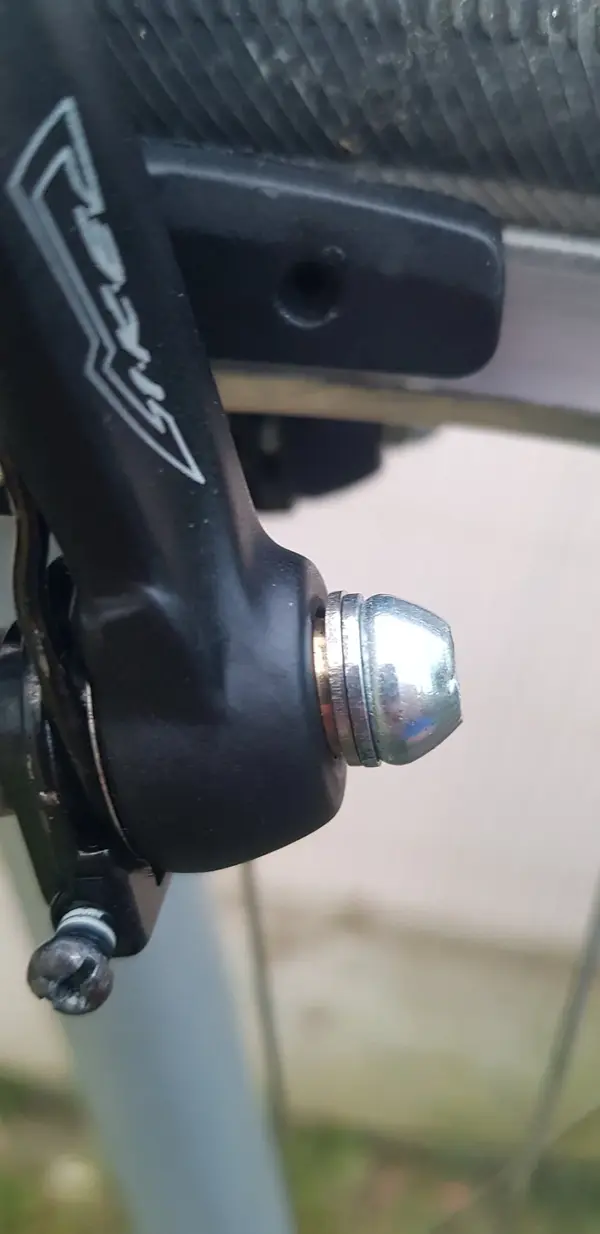

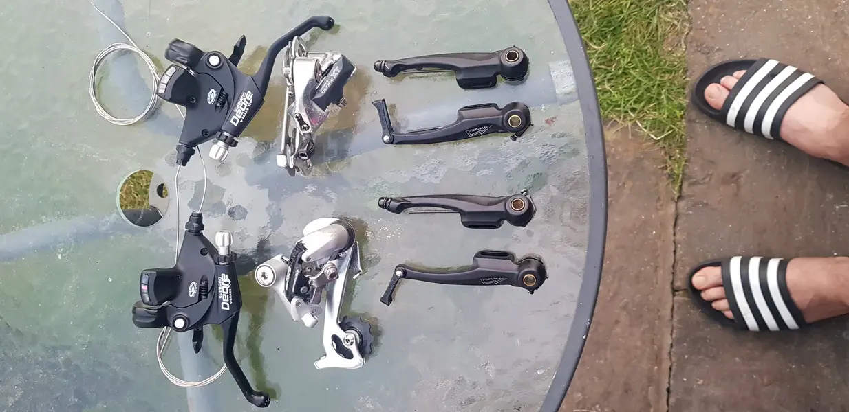

First problem today: I had half hour to spare so I thought to fit the brakes.
Front ones needed a washer because the bolts I had were a touch too long.

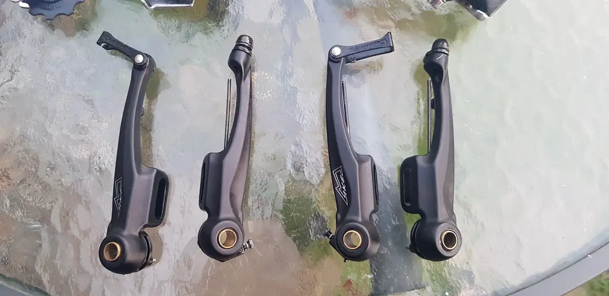

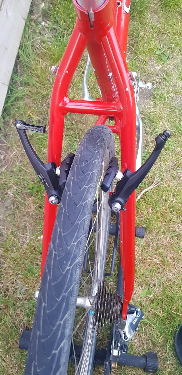

The rear ones were a bummer.
Some bright sparks had filed the brake brakets and were too short, so tightening the bolts would stop the brakes from moving freely.
Once again, my unlimited collection of stainless steel hardware came to the rescue in the form of tiny washers of (luckily) the correct size.
Threadlock added to all fixing bolts.
One and half hour and some swearing later, I finally got a result.

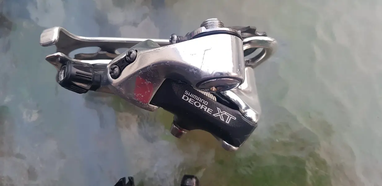

As you can see I also bolted the derailleur, that was a one minute job luckily.

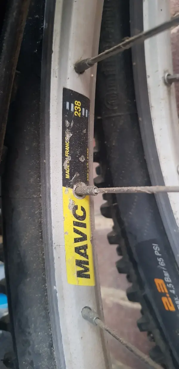

As you can see I temporarily fitted those campagnolo wheels
But I also have these mavic
Please don't look at the tyres, I will get better ones, but which wheels would you fit?
Both sets are in good condition although they need a good clean, and are perfectly straight.

Are all the bolts the same length on the brakes? Check you got them the right way around. I never realised until very recently that the rear and fronts take different lengths (giggidy).
Makes sense I suppose as rotation pushes the rear brakes inwards and the fronts away from the forks.
All same length.
They didn't come with the brakes, but from my collection of hardware bits and bobs 😂
Is there a different solution for the rear brakes where the brackets have been filed short?
Or what I've done is the only way?
