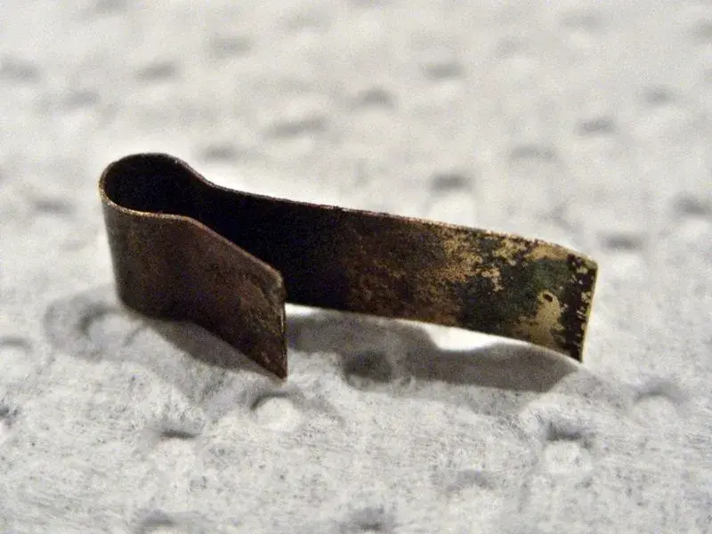

Inspired by this I have just stripped down my Atom freewheel. Recently the pawls haven't been engaging properly so I have been riding another bike. It's off my Raleigh Royal and is the original freewheel but hasn't always been on the bike as I ran a 6 speed for a long while. It is the best part of 30 years old though.
When I stripped it down I found that one of the pawl springs has broken. It's made from like a small strip of brass possibly. I just wondered if anyone has tried making replacements and if so how was it done? Not holding out too much hope but I'd have a go if I thought it was possible.

I've got the old springs out okay. They're like a flat metal strip. Somewhere in the garage I have a short strip of brass. I'll have a go at making a pair from that. The feeler gauge idea also sounds promising. I found a website (about boats I think) where someone is making new pawl springs from piano wire by wrapping it around a slim screwdriver and pinching it together with pliers. The method looks do-able for flat springs too so I might try that. The rest of the freewheel looks surprisingly good considering its age.

This is the fella. Probably about 12mm long. I just assumed it was brass because it looked brassy. this is the good one by the way.
Probably more trouble than it's worth. Just that it can't be more than 28 years old and I thought it would have been good for at least another 28!

Thanks for the picture... That always makes things clearer!
