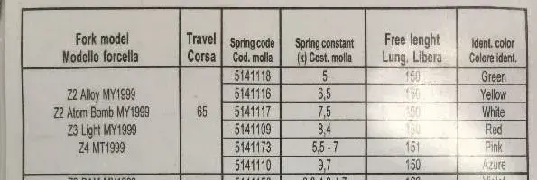

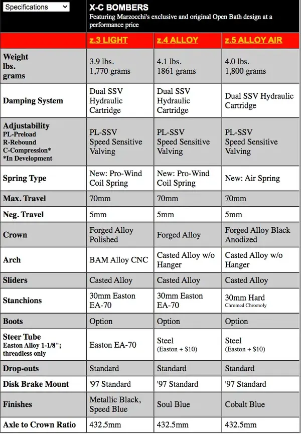

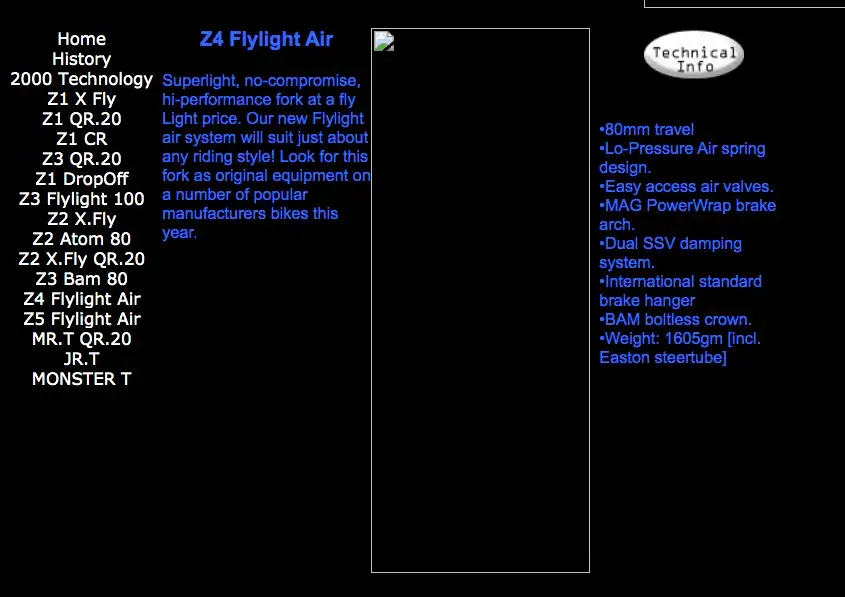

Some interesting useful chat in here. Have a few info grabs to go with it! Should be useful.

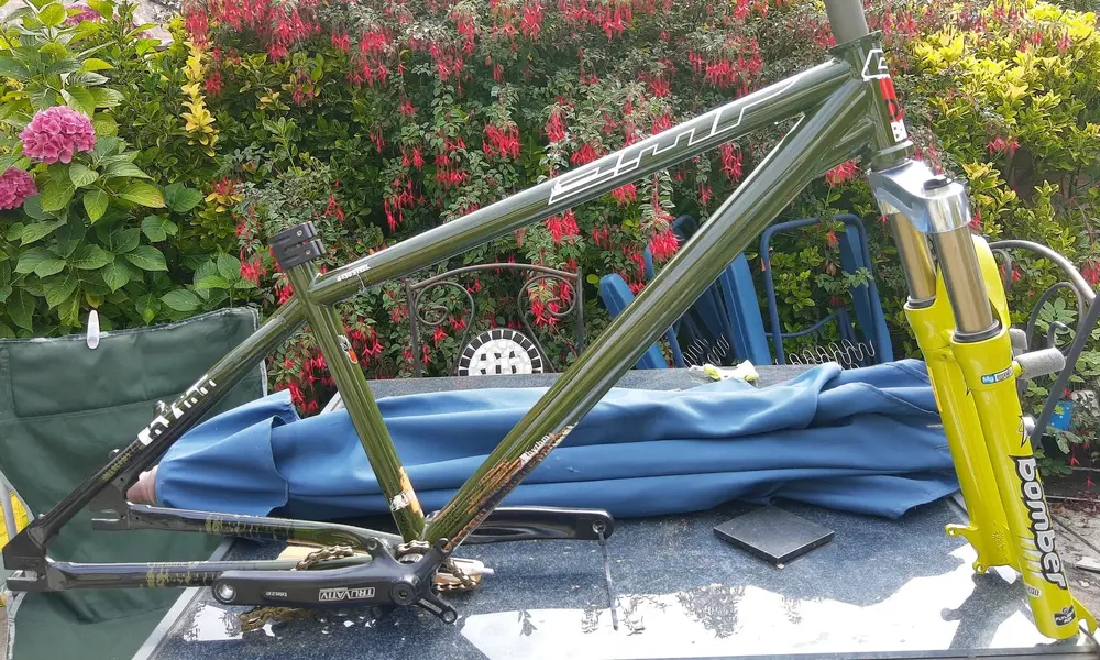

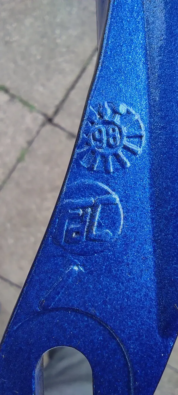

I bought one of each. I also have a Used Z3. First one going on my NOS Rhythm I think.
