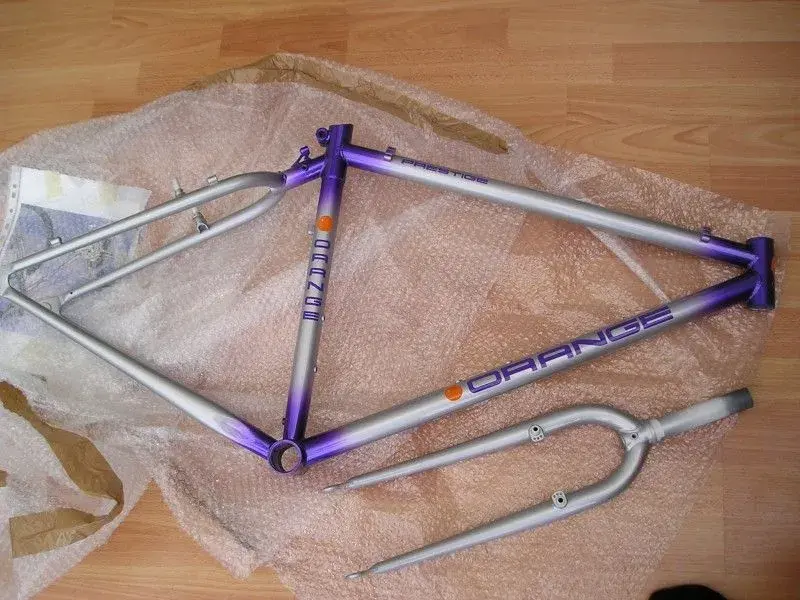

the quality of their work is very good, but the enamel paint chips VERY easilly. you would be looking at around 200 quid though
mine
