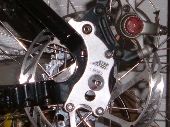

For the back disc you'll need an adaptor, like an A2Z, if the dropouts are flat. Otherwise you'd need to try and find something like a Woodman disco-system adaptor.

The a2z is a frame adaptor. The Woodman is similar to the 2B kit, basically a hub adaptor for a specific hub.
