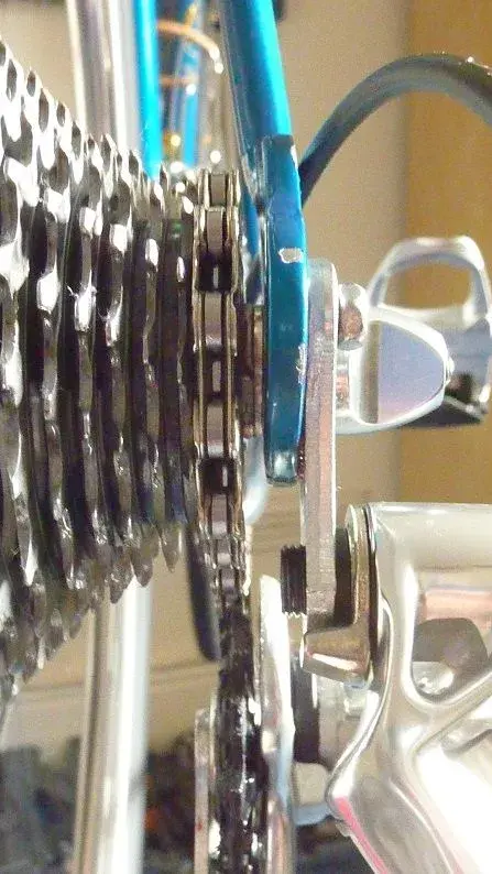

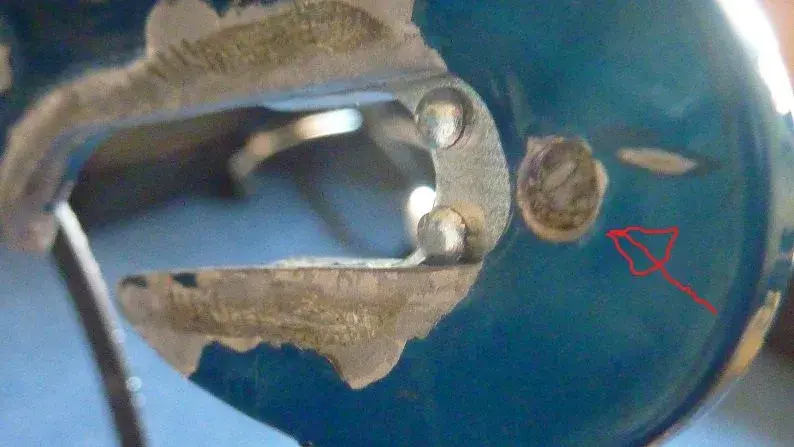

Am doing an update on my Gillott build soon...but here are some photos to illustrate how I got around that particular problem.
Note the drilled and tapped hole with the hangar retention bolt in place.
It looks closer to the cut-out than it actually is, around a 2mm clearance between the drilled and tapped hole and the dropout cutaway.
Sure...it puts the wheel back an odd mm but it works fine.
Post assembly. You see how tight things are around there...and that's with an additional 1.5mm of spacers on each hub.
If you use spacers....consider placing them on both sides to maintain your dish/alignment.
And as a final piece...check your hangar alignment after you finish everything up.

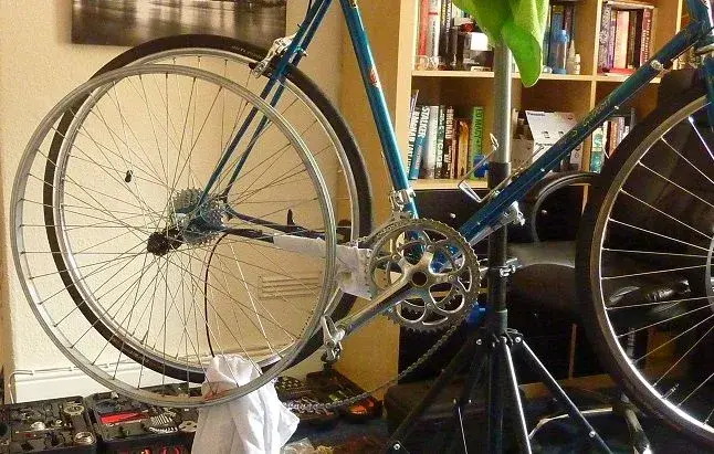

It's an absolute doddle if you have a spare wheel to hand that is threaded. Screw it into the derailleur hole, thereafter it acts as an alignmnet guage and with a small effort a re-alignment tool! See below. Yes it looks odd but it works an absolute treat and is a must check prior to setting up the indexing etc. etc.

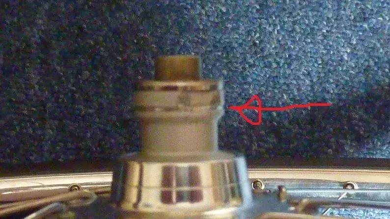

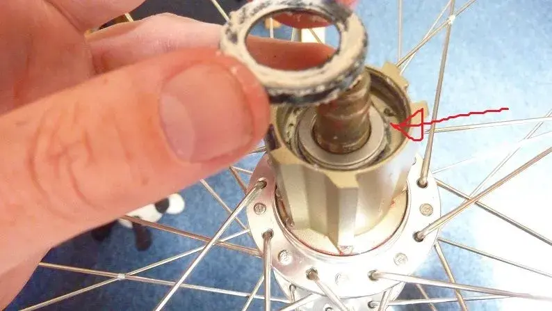

Here's some photos on where I put the shims.
You WILL need to take your hubs to bits (a little bit) for this...but not that much.
Non drive side shim spacer really easy on the novatec hubs. I had to purchase some 17mm cone spanners though! that was an arse!
The drive side was an arse.... somewhere inside the freehub and behind the main seal is where the spacers live......here an extra 1.5mm of spacing went.
This way you manage to retain your serrated washers and contact points to the frame and avoid faff when removing the rear wheel. Which you will do a lot to clean it!
'1952' frame.....'2016' 11 speed groupset... fun fun fun.

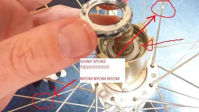

I'm going to apoligise for hijacking your thread.....in advance but....something caught my eye in that last photo....
yaaaay!
I'll feck off now that is out of my system!
