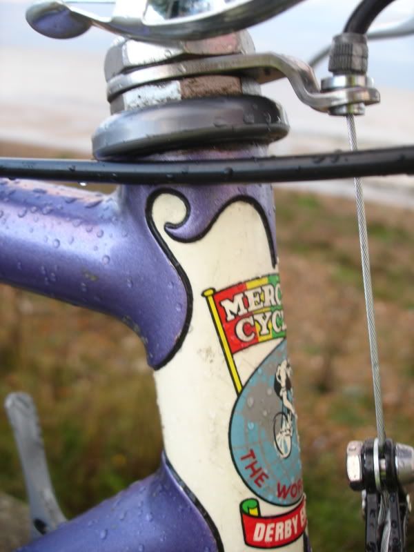

You really think the seat clamp cluster was added later? The filing of the head-tube the bi-laminate lugs seems like a lot of unnecessary work...... but i guess you could be right. These are the bi-lam lugs on my tandem, there is no way i would consider altering these.....
