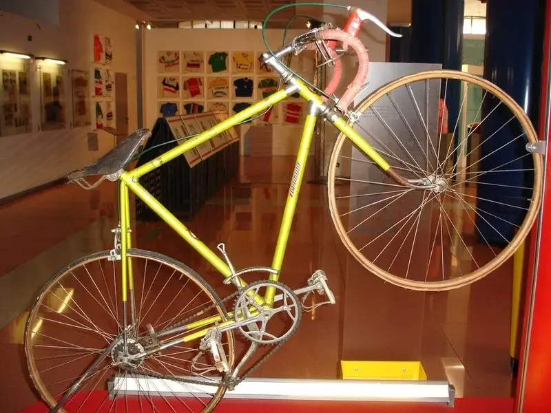

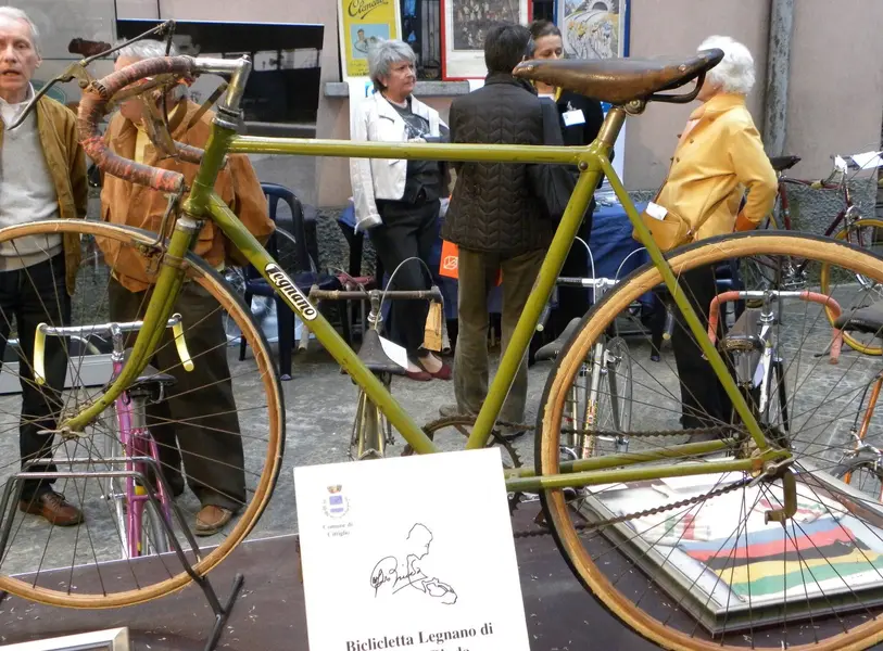

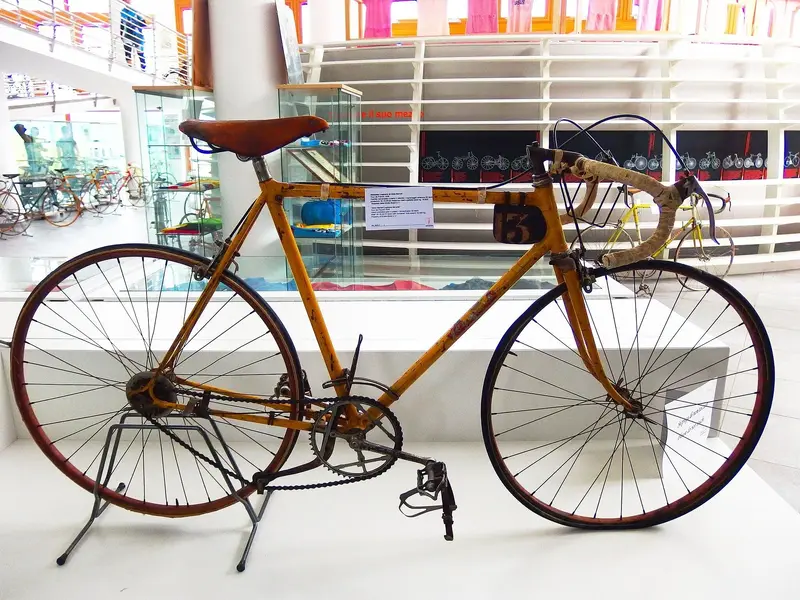

Thanks for the feedback . I've googled a little bit for Roger Lapébie (TDF '37 winner), Bartali (TDF '38 winner) and Coppi and the rim width does not worry me. It looks even better in my frame as it has a lot of clearance. Looking at some pics they could use these wide rims and fat tires too back in 1937 or 1938. I've just realized mines are for clinchers, not tubulars, maybe that's why they look deeper. I guess riders at that time would prefer tubulars they laced on their torso.

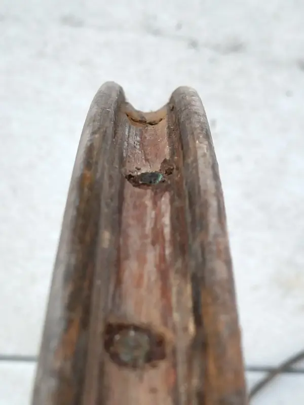

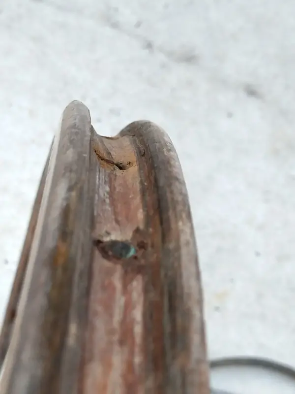

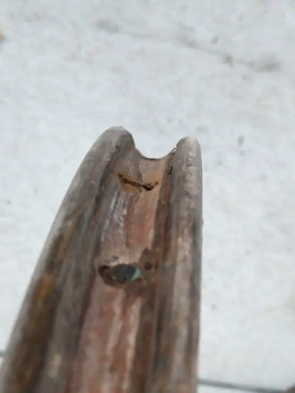

Clinchers did not exist then. Cycle tyres were either wired on or tubular. You are unlikely to get decent looking wired-ons, but you could reshape the bed of the rims to take tubulars, which are not so precise as to rim diameter. Check the diameter allowing for inflated tyre to be around 27 inches or a little less. You do not want the rims to be for 26 inch tyres.
Perhaps you could show a pic of the well of the rim.

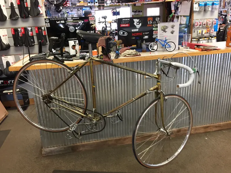

Here’s mine. I still ride it. It kinda shifts, better than a flip flop. I generally dismount at the bottom of a steep hill and spin, shift and remount. Shifting is not at all crisp, is ok on gentle rolling hills but doesn’t shift if you are pedaling hard. Its very light so it climbs well. I used it on a road and motorcycle racing circuit to do a 12 hour time trial and it was either built too lightly or the frame is worn out because on high speed right angle flat corners at the bottom of a hill the frame flexed so much that the chainring would rub on the front chain guide. It’s fine for road riding. My other vintage, but newer, (1960 and 1990) steel road bicycles were fine on these corners. My 1931 track bicycle with the gooseneck externally clamped to the fork tube would slightly slip and the bars would be a little crooked on these frightful corners. My goosenecks with jam wedges were fine. This TT is at night and only the corners are well lit, the lights turn on automatically when you approach the corners. I start out terrified and by 4 hours the field spreads out and I’m only uncomfortable taking these corners. Too many people don’t know how to ride track and cut you off, you need to use all three lanes of the track to make these corners. You will like your bike. BE8AD2BE-8DD0-49F1-AF5E-539766DD5424.jpeg
You need the changing fork as close to the cogs as possible, it could need a shim in the chainstay clip. You would then have to bend the changing fork up a bit.
Also I can't see if you have the tension release connected. If you wind the tension arm up a bit it will change gear better. You will never know exactly which gear you'll get, but with practice a quick flick and put the gear lever in the same hole it came from usually did it.

Here’s mine. I still ride it. It kinda shifts, better than a flip flop. I generally dismount at the bottom of a steep hill and spin, shift and remount. Shifting is not at all crisp, is ok on gentle rolling hills but doesn’t shift if you are pedaling hard. Its very light so it climbs well. I used it on a road and motorcycle racing circuit to do a 12 hour time trial and it was either built too lightly or the frame is worn out because on high speed right angle flat corners at the bottom of a hill the frame flexed so much that the chainring would rub on the front chain guide. It’s fine for road riding. My other vintage, but newer, (1960 and 1990) steel road bicycles were fine on these corners. My 1931 track bicycle with the gooseneck externally clamped to the fork tube would slightly slip and the bars would be a little crooked on these frightful corners. My goosenecks with jam wedges were fine. This TT is at night and only the corners are well lit, the lights turn on automatically when you approach the corners. I start out terrified and by 4 hours the field spreads out and I’m only uncomfortable taking these corners. Too many people don’t know how to ride track and cut you off, you need to use all three lanes of the track to make these corners. You will like your bike.View attachment 602017
That is very nice! I'm happy to have a "sister bike" here. These are modern hubs aren't they ?

I spent almost half an hour removing the clinchers! Solution was to saw the wires . Anyway, re-shaping the bed looks feasible and it will help to hide some dents on the flanges likely caused by someone else trying to remove the same clinchers !
Not to much to remove, maybe just some sanding will do. A big tube (30, 32, need to measure yet) will fit well already as there is already a big/wide surface contact. I'll probably end up making a pice of wood with kind of desired shape / template and use it with sand paper.
But first I need to fill any crack with glue and clamp it all with wood ribbons , side by side, and little by little getting the round shape. Once the rims are done, look for new hubs and lace them. I will wait to start with this to have the new hubs with me; don't want to start removing spokes and leave the wooden rims too long alone if they could loose shape.
Here the pics of the rim. Next stop: crankset and bottom bracket before starting with the Osgear !
