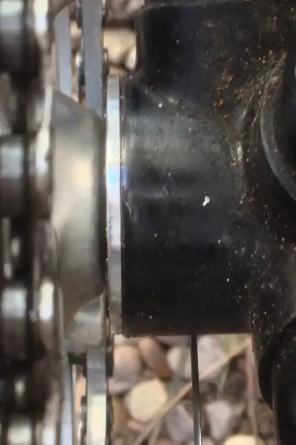

New BB and Crank New PROBLEMS
There's no "fix" as such, if it's out then something isn't fitted correctly.
Check the BB is fitted properly: is there a gap between the cups and the frame?
Are the cranks fully on? Hold the ends of the crank arms and try and wobble it left to right: there shouldn't be any play.
It's a tifosi 102mm bb. All sugger up as tight as they can be. They have like a lip so it can't go in any further :-( humm
Because of the long rear triangle / chainstay "dent" it will clear it but the crank looks way to close to the fixed cup........
Shaun
Front chainline.
Looking down on the chainset from directly above, what is the gap between the chainrings and the chainstay?
I'm with Shaun: your cranks look to be sitting too far on the spindle.
My first thought was that you had a JIS BB and an ISO crank, but that would result in the opposite problem.
Aha cheers mate, it rides ok now and iv stuck a spacer in it now anyway. Going to take it to the old bike shop owner and get him to have ago. He is realy good and if its a small job probs don't even charge.
