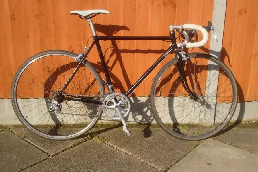

So I finally got it to work! Thanks guys I know you guys could see all the problems but this is my first time building up a bike. I had to take the spacers out the FD cage to make it narrower as you can see per picture but it runs fine now with about 1mm clearance from the crank and I set the Limit screw on the FD so it won't hit the crank. But yeah here is what my bike looks like so far guys

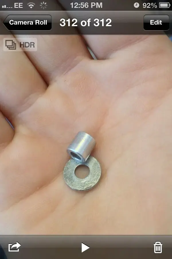

Ah good.. you may need some spacer, or that bolt will work loose... Got a bit of chain? try using one of the rollers as a spacer. Looks like it'll be about the right width.
Yeah I though that. I will have a look for somthing I can use as a spacer. Just glad I got it all sorted. Need a new free wheel now and wheels

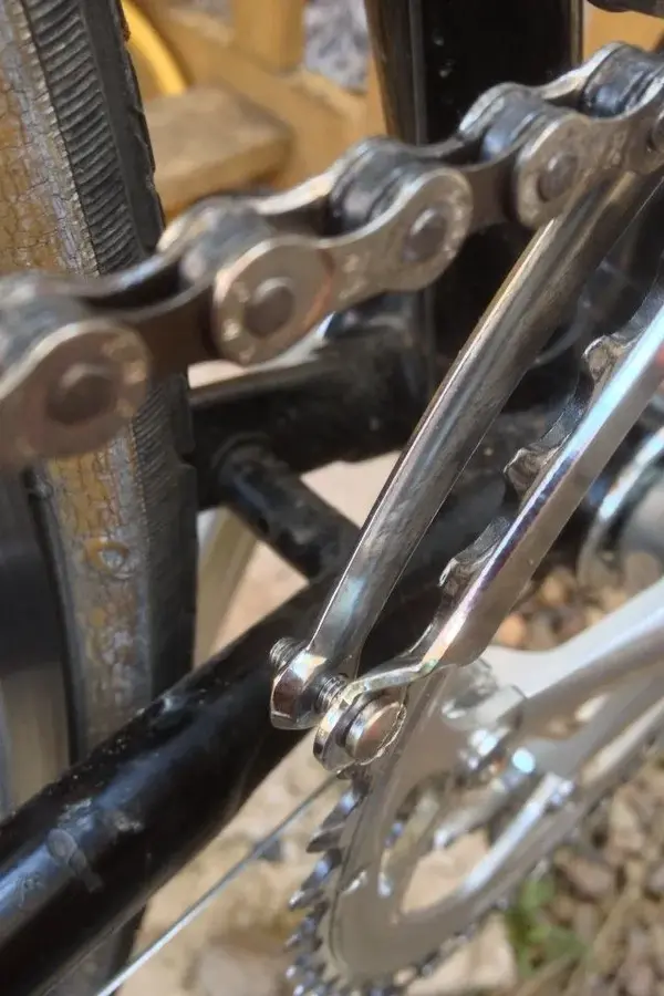

I'm glad you've got it to work, but your bodge may be masking other problems: obviously something is still not right if you have to close the derailleur cage up to get it to work.
It's hard to tell from the photos, but your chainrings look to be too far out from the frame: what is the chainline?
EDIT
Looking at the third photo you posted on the first page, the chainring does look to be too far out: there should only be a couple of mm between the inner ring and the chainstay and no more than 1cm or so between the outer and the chainstay.
That was my first though aswell, that is was out to far but it's defiantly the right bb for the crank. I sticks out about 2mm more than my old crank and bb did but dont know how to get it in any ferther. Chain line looks fairly good though. Any suggestions how to get the crank in abit more?
