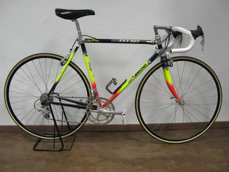

sorry Iam a newbie - so this is mine TVT92. It's the first bike of beginning a carbon bike collection.
It's a HM version . I used assos tubulars rims and a Turbo saddle.
But I don't know exactly which rims had been ridden by Greg Lemond within this Z-Team bike. Campagnolos OMEGA or OMEGA V - or any other Italian like Ambrosini or FIR. I had a pair of FIR Pulsar (but they have 32 holes)
Further I am looking for a SCOTT drop-in handle bar and a correponding stem (Cinelli?) because the 3TTT combo are not really correct. someone ca give me a tip where I can get this items.
In the meantime I am also working on the completion of a LOOK LDS KG 171 ONCE -Team Bike of 1997/1998 of Jaja!
I try to investigate which wheels and components (excl. Campa Record Titanium) had he used when he had ridden it. But I can't find so much photos within the web.
Thanks for your help in advance.

...sorry - now I think it'will be nearly complete after last changes
instead of the Chorus parts - now with a nice Campagnolo C-Record Crank, a corresponding Rear derailleur
a Scott drop-in bar , a Selle San Marco Concor and a pair Campagnolo Omega 19 tubulars with Campagnolo hubs
Hi The Z team 1990 used 8 speed down tube shifters NOT ergos on the TVT's, They also used Campagnolo rims not 100% sure which model,
I'm 90% sure that the Stem was a Scott or a 3ttt Rebadged as Scott Maybe the Record 84 model?
Pedals were the Time White Equipe & the Silver/Grey Titan models. Tubs would have been 23mm for road only 19 20mm for TT.
Nice bike though all the same WELL DONE

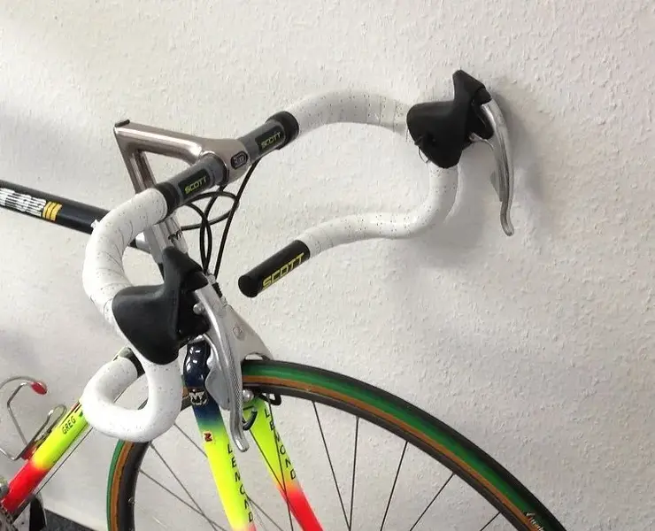

...yes indeed you are right - Greg Lemond used 8-Speed downtube shifters - but I am a kid of Ergopower/STi - Age.
So I decide to use these 1st Gen. Ergopowers and now I want not destroy this really nice SCOTT drop-in bar ( I build it with glossy black coloured adhesive
lamination and 4 yellow Scott stickers
. The stem is a 3ttt record 84 - I haven't found wihtin the last several years a SCOTT quill stem.
The rims are Campagnolo's OMEGA 19 tubulars with Vittoria Corsa SC (I think these are the best Retro-looking tubulars at the moment)
The Intention to build up this bike was to take part with it at L'Eroica in 2015 - Then it will have an age of 25 years.

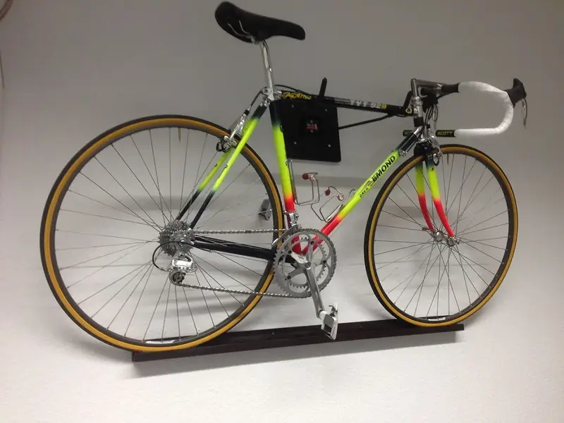

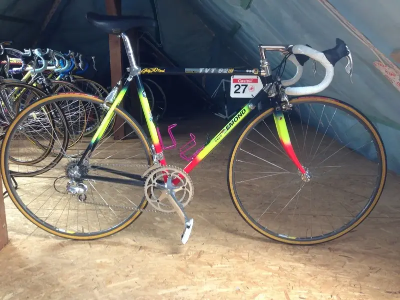

so this the actual Version - now with number plate and 2 pieces of purple T.A. Specilaites bottle Cages
... the next step will be to dismantle the Ergopowers and supersede them by ordinary Campagnolo C-Record brake Levers with white hoods and corresponding downtube shifters.
After this mentioned modification I will come back with photos of the result
