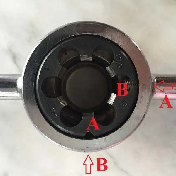

You don’t need to, you can make one!
Drill out and re-thread the old grub screw hole to the next size up, file/chamfer the end of the new larger size screw at 45degrees, then use this new screw to push the die open so that it doesn’t cut so deep.
(Yeah I know it’s quicker to type than to do)
