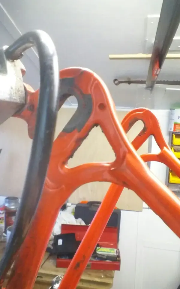

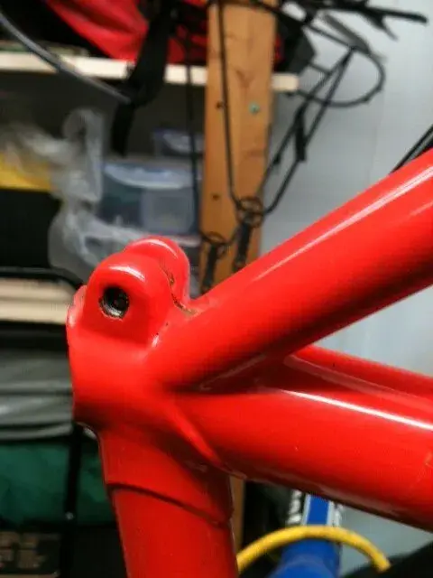

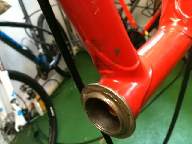

I've recently gained a new frame, but can't identify it, fast track stays and threaded binder,birdsmouth lugs,campaign dropouts chrome forks with haden type crown.
The frame number is partially obscured by later branded on cable guides and weld "repair" for a stripped bb. Any ideas?

It doesn't remind me of a Carlton Pro, the early Pro has the fastback joining a little lower down, later pros had oversize seat stay caps like a Raleigh. Bottom bracket would have been slotted or had CC cut out.

I've seen 80's frames like that badged for a variety of bike shops.... Roy Thame for example.
How much does it weigh?

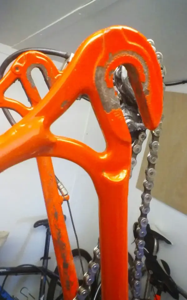

That's not too shabby :). Have you got a pic of the rear dropout / hanger to see how the metal is finished.

A couple of photos one of each dropout

Portacatena dropouts with very Raleigh / Carlton stay end finishing, I wonder if its a Carrera?
