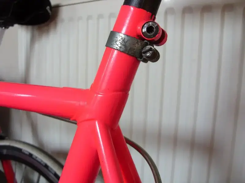

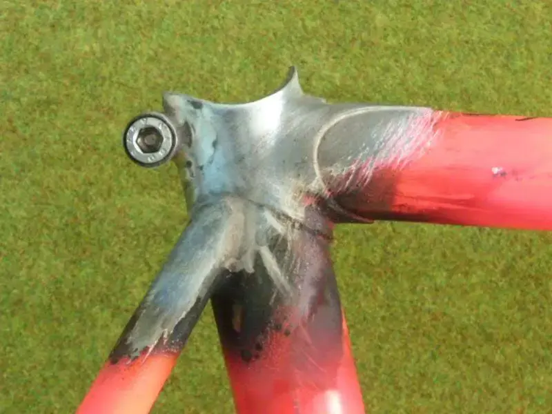

What 'can' happen with a seat post when higher than the max limit marker!
Note the kinked section at the lug also the clamped section had cracked badly.

@ Ian Raleigh
I see what you mean. At the moment the 350mm seatpost does not have the limit mark exposed, and goes about 1cm under the bottom of the top tube weld than on the first photos I've posted. Hopefully there will not be any problem until I buy a new one or repair the 400mm BBB I have.
Also, I have been looking at some photos from the late 90's to see for how long I may have used it before, and I think it was on the bike for about 2 or 3 years without damage to the seatpost or the frame. Later I've replaced it for a suspension seatpost from Rock Shox that had the dame length with same results.
Thankfully I do not detect anything like what you've shown in your photo.
Glad you can spot kink in the metal :shock: As long as the seat post sits an inch below the lug/seat stays, the frame may never suffer from
any buckling, imagine the force implied by a very long seat post against a tiny bit of round metal, two parts may give eventually..
Bend the seat post or buckle the frame or even worst it snaps clean off, it has happened.
I purchased the bike because of the knackered seat tube extension, the frame was my size so I had it 'fixed' :wink:
